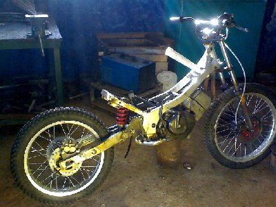

welll...im not pretty lucky, i really love this sport, but since theres no dealer seller, or what so ever that sell any of trial bikes here in Bali,.. i decided to build my own :D
but i dont know if its going to work as good as fabricated, (off course NOT!!:D)
the bike it self built from a 120cc suzuki satria (gonna name it Suzuki saTrial 4RT :) after it finish.. cut the sub frame, change front fork with an old showa air suspension from other bikes, change the holder, change the tire and wheels(alumunium) add rear disc brake..
i have some detailed pics of the whole project, but the internet connection here is slow so upload only one :(
it hasnt been finished yet, im curently dissemble all the parts for a paint job, as im writing, im workin on the fiber parts, for the gas tank and rear fender
im expecting some technical issue from u guys, heres the latest pic before the dissemble..

Welcome! Top effort with the satrial =D> .Im looking forward to the progress updates.
What motor are you going to use?
Have you worked out how much it will weigh?
Good Luck with the build.
Drakey

hi drakey, nice to be here,
the motor is 120cc jet cooled 2 stroke suzuki( on the picture), i might have to bore it up and raise the compression to get enough power,
the weight so far is about 40-50 kilos, i havent measure it yet, but i can easily lift the rear wheel with one hand( with the engine fitted)
when its done, i personally invite you and all the community to my farm(in bali of course), ride the slipery stone and dirt!!! :D cant wait =P~
