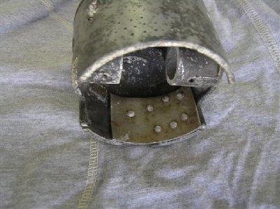

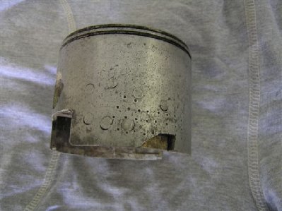

I was about 16 and the piston in my Bultaco 325 Alpina was pretty worn and rattly. Compression was OK. My Dad had seen piston skirts knurled in much bigger motors (aircraft piston engines) to resize them and had an idea. I pulled the barrell off and my Dad reckoned that if the piston skirt could be resized, it would be much quieter while I saved up for a rebore and new piston.
We resized the skirt by making a steel dolly that fitted against the inside of the skirt and carefully centrepunched the outside of the skirt about 100 times on the front and back skirts.
This worked a treat. The motor was nice and quiet for about a month, then it suddenly started making a terrible piston rattle. Pulling it apart again, I found a crack that ran up from the bottom of the skirt about 20mm. There was also a small piece of skirt missing (broken off) from beside where the crack met the bottom edge.
I still couldn't afford a new piston yet so my Dad made a 3/32" thick patch from sheet duralumin and we riveted it on the inside of the skirt using hand driven aluminium rivets. The rivets were countersunk heads with the countersink end on the outside.
The bike ran fine for ages after that till I could finally afford the new piston and rebore.
I have kept the old piston (33 years so far) as a reminder of what you can do if you have to to keep a bike going.
I'll post a photo of it in the next few days.
Re: Sunday improvisation
This is the Alpina piston with the patch on the skirt

David Lahey wrote:This is the Alpina piston with the patch on the skirt

The great part to the piston story is-you have the piston to back up what you've said.How many times do you here stories that can't be real.
