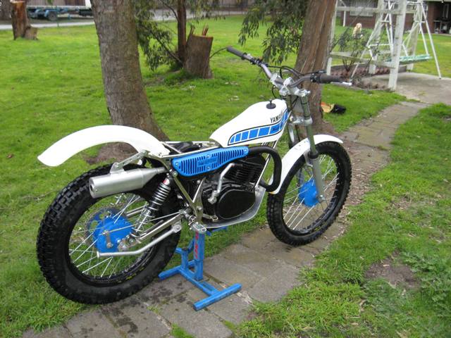

David Lahey wrote:BTW congratulations on winning the TROY series in Veterans. Mate you are a legend. Is anyone going to post photos of the riding from last weekend? I'd love to see that Majesty in action.
Here's one I had lying around, sans seat and the be-yootiful gold Ohlins.... Beechy you'll have to take a recent one!
Keith.
