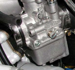

Hi Brinky,
I assume your talking about the standard Dellorto?
Best place to start is with the standard Sherco specs and work from there.
Take the carb apart and give it a good compressed air clean up. And make sure those two vent tubes (one either side) are completely clear. Also, check the float height is correct.
Best of balance.
Neo

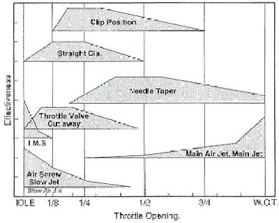

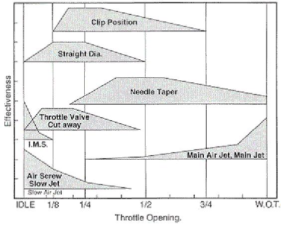

Stork955 wrote:Also, a clarification for mixture setting -mixture screws only affect idle and very slow speed running. Main jets only affect full throttle. Slide cutaway affects the transition from idle to open throttle and the needle pretty much does the rest.
Something like this..
Best of balance.
Neo
Re: Sherco 290 Running Lean
Dear Stork,
Great Diagram.
What is the I.M.S just below the Throttle Valve Cut Away envelop.
Regards,
Brinky.
Great Diagram.
Regards,
Brinky.
