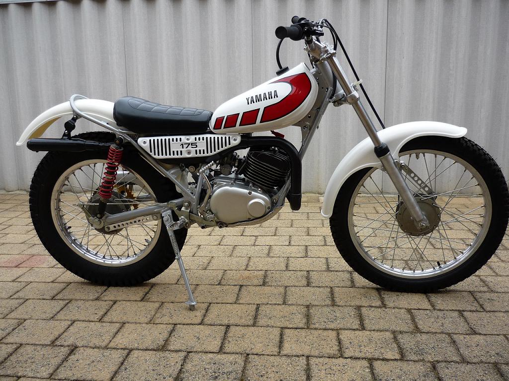

Hi all,
the closer I get to finishing this project, the more money it seems to consume! I'm 99% there, just need new shockies to finish. However..... I ran this bike for the first time last week, mechanically it's all sweet as a nut (should be, as just about everything has been replaced) but it doesn't run too well from say tickover to maybe 30% throttle. It idles nicely and goes very well above 30% but seems to be lethargic off the bottom, lots of intake roar and no go. It is a little better if I apply a bit choke. I have replaced the main jet (240), pilot (25) and needle 4L6, centre notch. Slide is No.3 with no wear marks, nozzle is O-0. I have set the timing as near as I could.
My question is, where do I start to troubleshoot, ignition timing or carby?
Thanks - Mark

Re: TY175 restoration
Sounds like the pilot jet is blocked or part blocked.
Spot on David, the pilot was blocked, it's almost right now but it's still not as responsive right off the bottom as I'd like, maybe I should try a 27.5 or 30 pilot jet?
I'm assuming you have a standard airbox arrangement and end muffler for the 525 model. The 1N4 model has a rubber silencer on the air box lid and a more restrictive muffler which will affect the jetting if you have the carby setup for the 525 model. It doesn't matter really which setup you use but the carby jetting has to match the muffler and the airbox lid and your jetting numbers sound right for the 525 model.
Hey David,
spot on again! The unused autolube inlet on the carby has never been sealed, thus air leaking in downstream of the carby.
Are you sure the plug gap should be 0.3 - 0.4mm? My manual states 0.5 - 0.6mm
Thanks - Mark
Thanks - Mark
Yes you are right about the spark plug gap. I was thinking of the points gap. Good to hear you have it going well.
