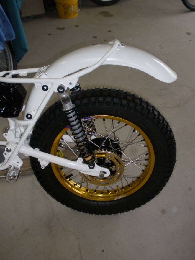

And especially Dino! Congrats on having a go at getting the KT going. I have just finished restoring 2 myself, so here is a few tips!
1. You have found http://kawasakikt.tripod.com/FREDKT.html - that will get you a long way!
2. Cables - original try Ebay USA, aftermarket try http://www.venhill.co.uk/. I have one bike setup with each option - Venhill won't do a throttle/oil pump cable though
3. Original throttle - again try Ebay USA - I got one but don't expect to pay less than $250.00. I have dibs on the first LH grip that surfaces on the planet!!!
4. Fork sliders - I got mine rechromed at http://www.radhardchroming.com.au/. About $300 plus shipping and does COD.
5. Shocks - originals are non-existant, and if available are worth over $1000 per set. I used these http://www.falconshockabsorbers.co.uk/ - shipped from UK about $300.
6. Carb kit - good luck. Disassemble and take to local Mikuni dealer to try match jets/needles.
7. Wheel, headset, and engine bearings - got these all from local bearing shop - I used NSK but pick any good brand - is less painful than trying to get original.
8. Sprockets - originals are hard to find and rear is dished. they do come up on occasion. I recommend finding board member "I Russ" and buying a sprocket adapter/spacer from him. Once you have this you can use KX250 sprockets and 520 chain!
9. Swingarm bushes - a got some machining done so I could use roller bearings, but others have made brass bushes. Original rubber bushes are rare.
10. Electrics - again try Ebay USA - they come up but are super expensive.
11. Engine - I have a 1973 Honda CR250 piston and rings in one of mine (Wiseco), and you can use a KX250 conrod kit if you buy Fred's cylinder spacer. I think I bought the last NOS KT rod on the planet.
12. Frame rails - I had mine replaced due to damage - just make sure the fabricator puts the engine in when he puts the new rails in because they are very tight to the engine.
13. Clutch - you can get original from Kawasaki, or from Ebay USA, but I got a Barnett clutch kit for mine from Ebay. Only new so far but feels OK.
Hope that gives you a start anyway, I have found best results for parts to date is Ebay - US, then AUS, then UK in order of regular sightings.
See attached pic for look at Falcon shocks, I Russ adapter and KX250 sprocket.

Falcon shock, I Russ adaptor, KX sprocket
