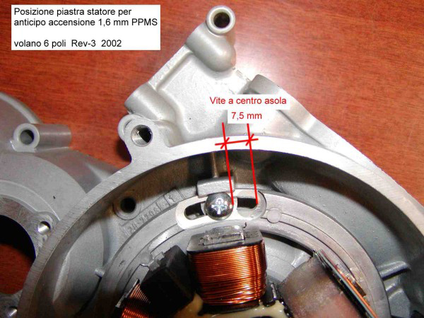

2. TIMING:
Check ignition timing (as per diagram) see: http://www.betatrialuk.com/content/view/72/51/

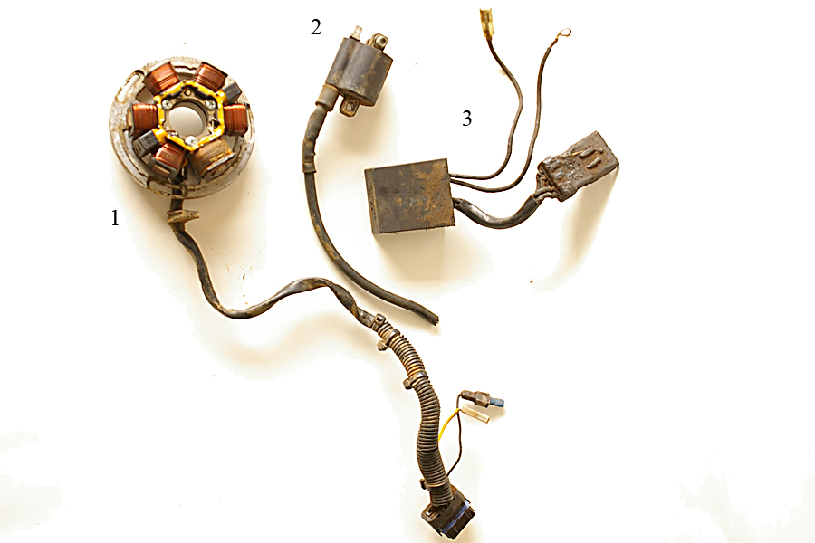

3. STATOR COIL (item 1 in image)
I have replaced my Stator - apparently the winding wraps on coils deteriorate over time and need replacing. Best off ordering a replacement Reconditioned stator from Kal at KD Mototrials
4. CDI UNIT (item 3 in image)
I have replaced the CDI unit as well - mine was old and tired.
5. Spark plug COIL (item 2 in image)
Has been replaced.
Before these changes my bike was very difficult to start and would stall when idling (even when warm) - now it is like a different machine, starts first kick (2nd when cold) and idles well. Bike mechanic told me it had a very weak spark before replacing all these items.

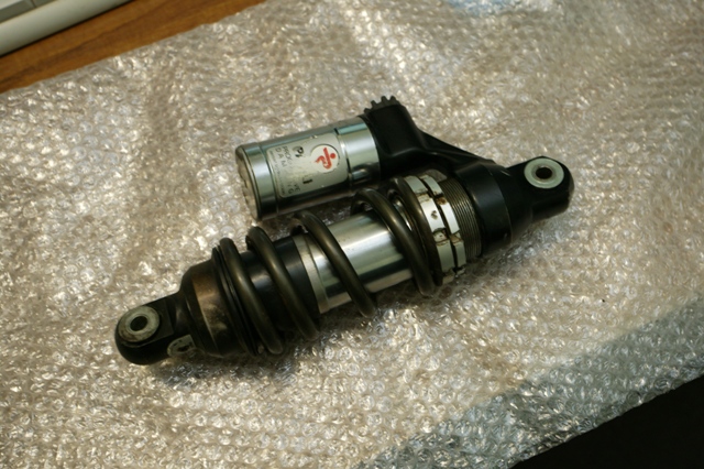

2. Get the rear shock serviced before it's too late! Mine blew up on me and it wasn't pretty - destroyed itself internally so had to be replaced. To replace with a suitable 2000-2001 model "piggy back" shock is nearly impossible (and very expensive). Good news is a 2002+ model shock will work if mounted correctly (I ended up importing a reconditioned unit from Beta UK).
