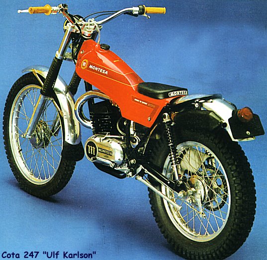

247 Cota (M21 motor number prefix) has the shifter on the LH side of the bike as you sit on it. Rear brake pedal on the RH side. The gears are one down and four up.
When new, 247s were are a very simple and basic bike - piston port induction, points ignition, 27mm flange mount AMAL Mk1 carby, no decompressor, drum brakes.
Have you had a look at any other bikes of the same model to compare? There are many photos of 247s on the internet. That same website has a gallery of brochure photos.
Here is one showing the LH side of an Ulf Karlsson Replica 247 which was the 1977 model 247. The engine covers on this model are different to the earlier model 247s.
