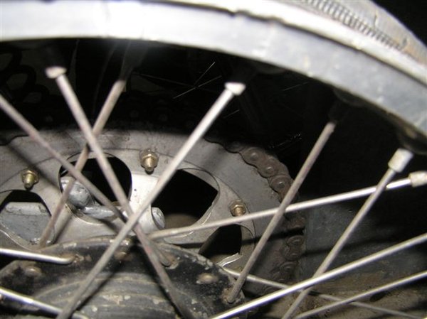

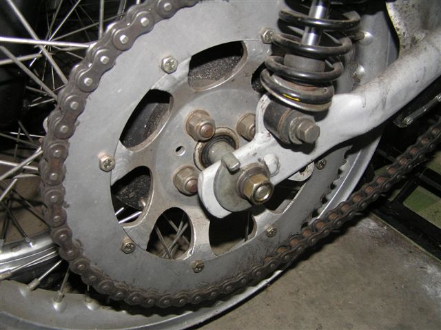

Photos of rear sprocket. The original sprocket was machined to form a spigot and and the new sprocket was machined to fit onto the spigot with a matching recess. The 6mm bolts hold the parts together.
Another alternative to this is to weld the joint instead of bolting.
Another alternative is the Sammy Miller Products rear sprocket kit that includes a hub extension and another bearing and allows flat sprockets to be used.
David
