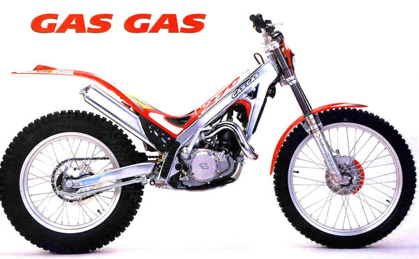

From a community member:
"How and where is the oil filler on the 1999 270 txt gasgas,we have been taking off the cluch case to fill it.Just can not seem to see a oil filler hole/plug? any help will be great ,it's a pain doing it the way were doing it now."
Can anyone locate it on this pic?
Keith.

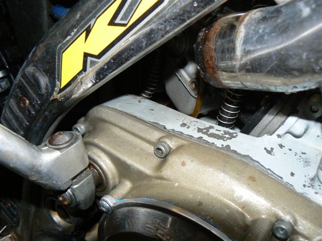

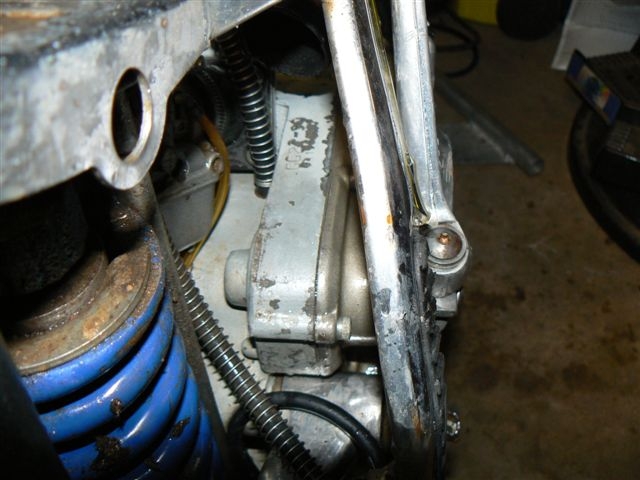

Hi,thanks for your reply's.I still can not seem to find that filler.I have taken a few photo's to show and if it was above kick starter on crank case would be under mid-chamber and I can not see one on outer cluch case #-o
