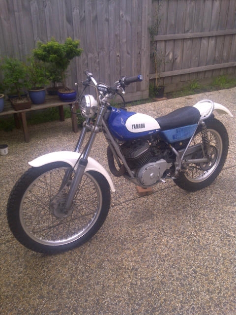

Hi All,
Ive been scanning this forum / site for years now, but I dont think I've ever posted. My name is Lachlan, and I'm trying to get back into trials after a 15 year absence! A short while back, I managed to secure a 2 owner TY250C, which allegedly has only ever seen farm duties. The overall condition wasnt too bad, and price wasnt overly inflated, so I snapped it up. Having not restored a TY before, I thought I'd better ask the local experts for some assistance.

- Pic of bike as I bought it
- 7532768_20.jpg (92.56 KiB) Viewed 7436 times
