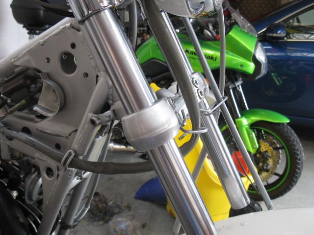

1I made this wire loop up based on some advise gained hear is it the right shape and position to hols the loom
1 loom holder (Small).JPG (43.73 KiB) Viewed 2327 times
1/1 the cable really wants to sit hear and is barely touching anything which says to me its in its happy spot.
1.1 loom position (Small).JPG (57.53 KiB) Viewed 2327 times

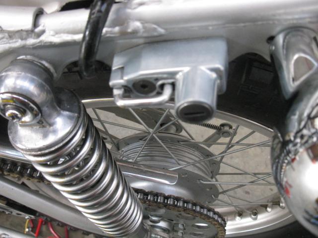

3 Is this the right helmet lock?
3 helmit lock (Small).JPG (52.96 KiB) Viewed 2327 times

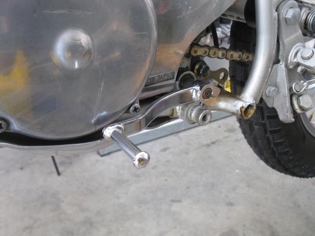

6 is the gear leaver supposed to have a rubber on it?
6 gear leaver (Small).JPG (39.29 KiB) Viewed 2327 times

1.1 ........ till the forks are fully compressed
6 I think it might be the wrong gear pedal - but will have to look at my sister's totally original JC to be sure
