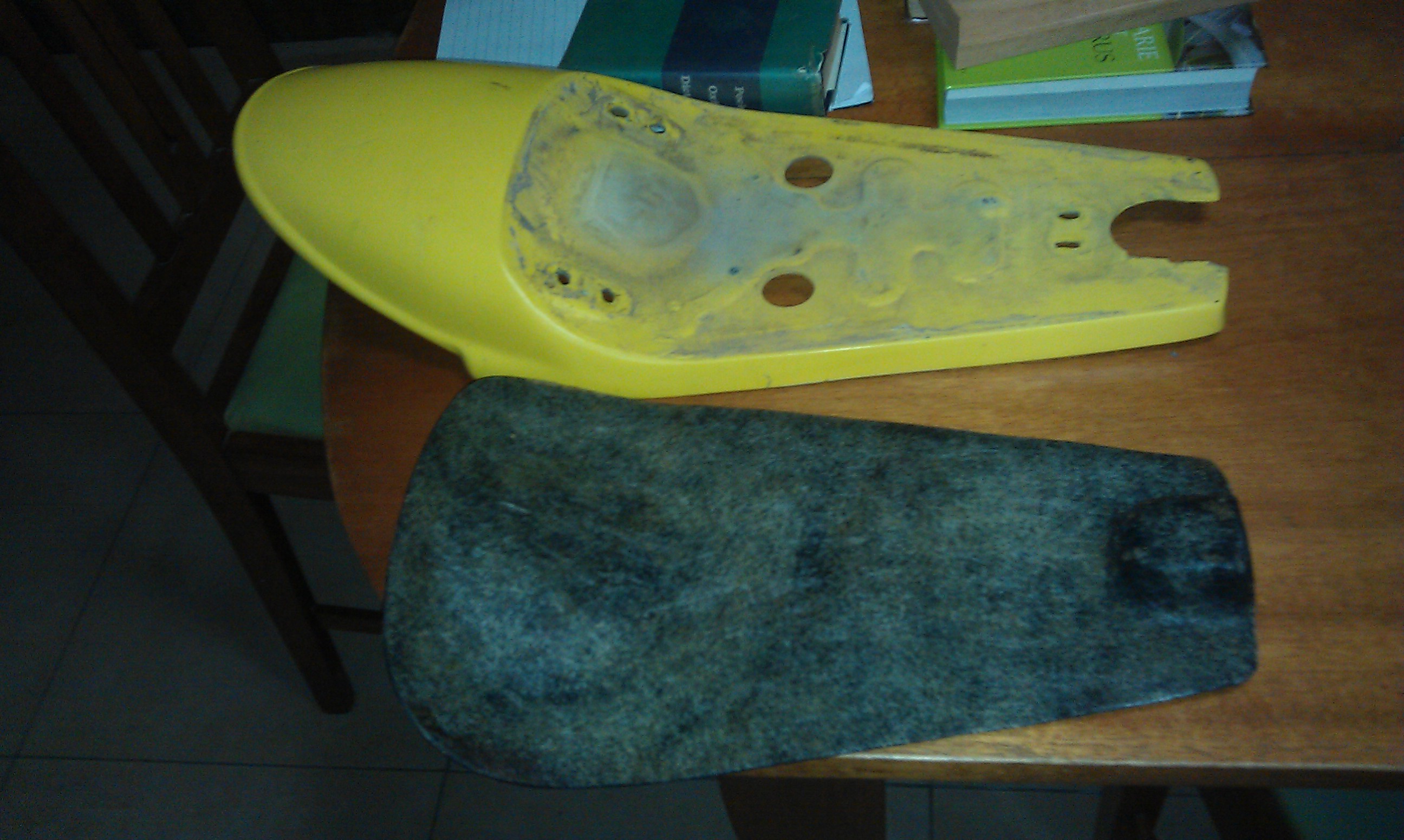

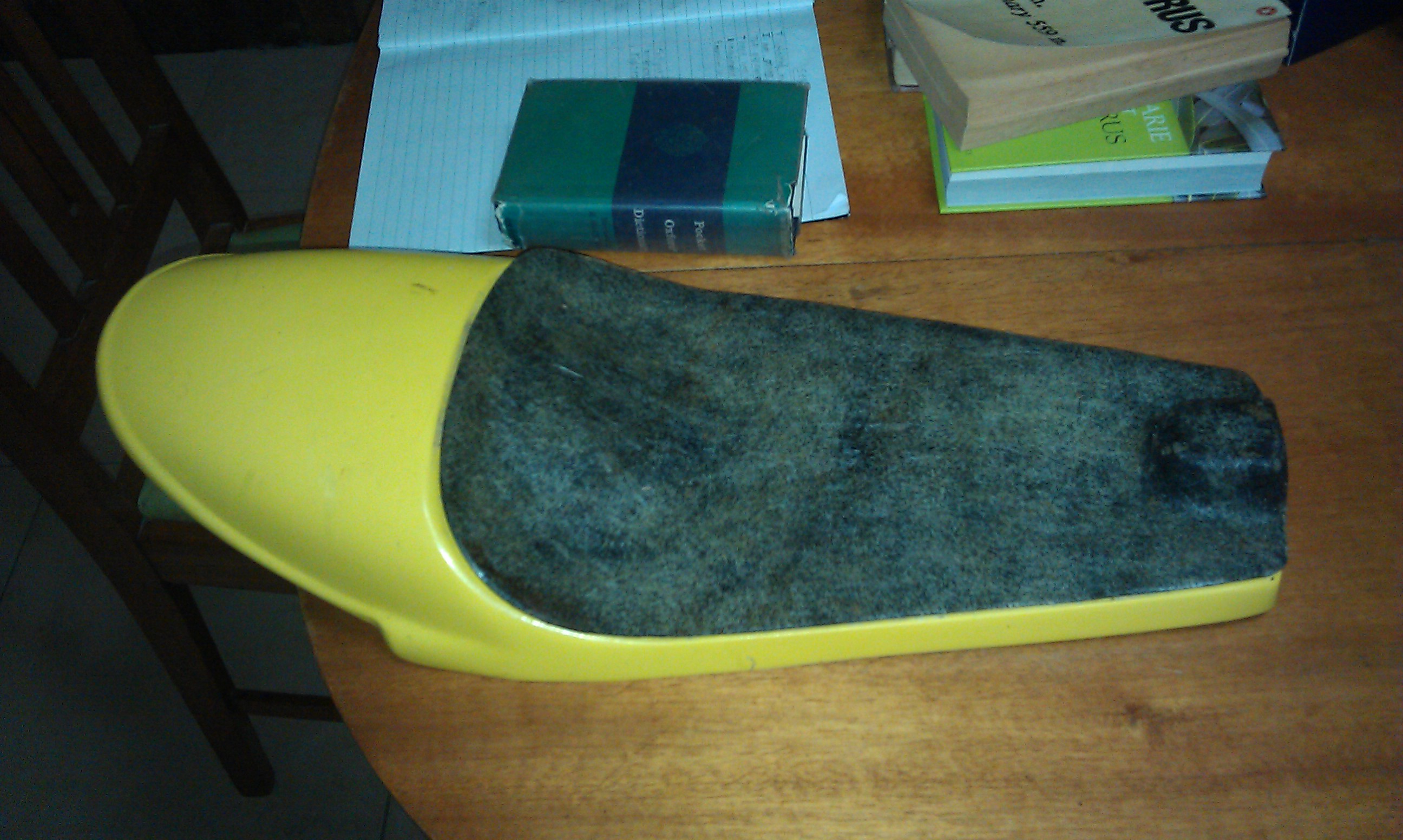

curled seat
curled seat
Re: TY250A SEAT
Tim I will bring something out on the weekend that I'm sure you will be interested in
Re: TY250A SEAT
I went and got this from the shed so I wouldn't forget it

Looks Interesting.
