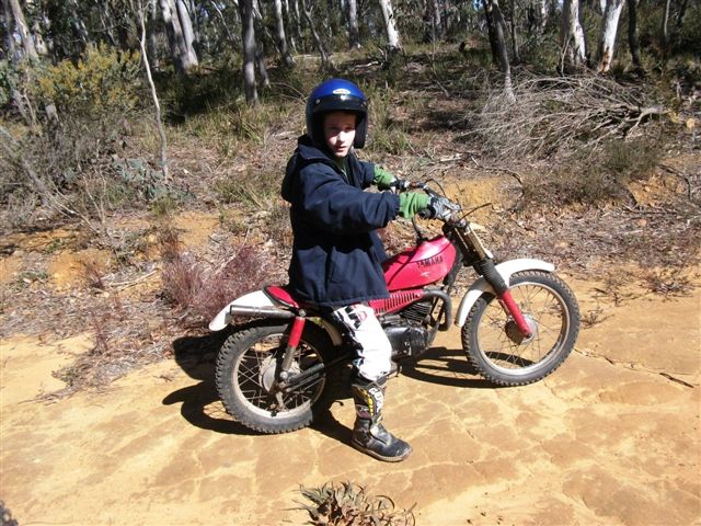

Bike Ride 036.jpg (97.75 KiB) Viewed 10152 times
Here is ours... two weekends ago it was ridden by Bailey Boniface to 1st place in Junior Class at the NSW Twinshock Titles.
This identical twin brother thing is getting really spooky !!!!!!!!!

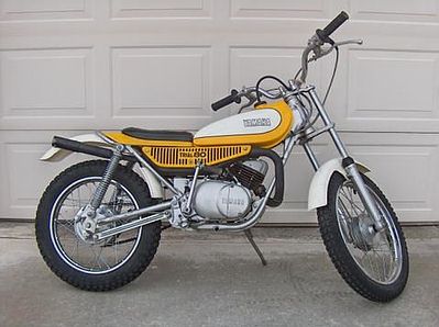

Re: TY 80 info..Resto now started.
Heres the brochure shot I was thinking of
