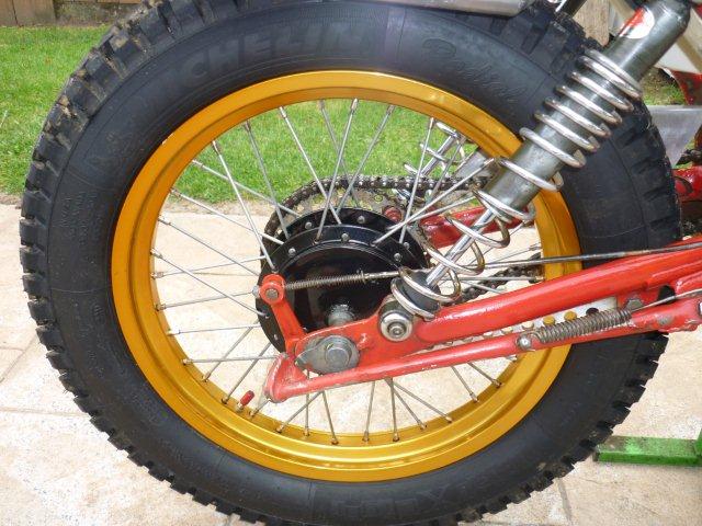

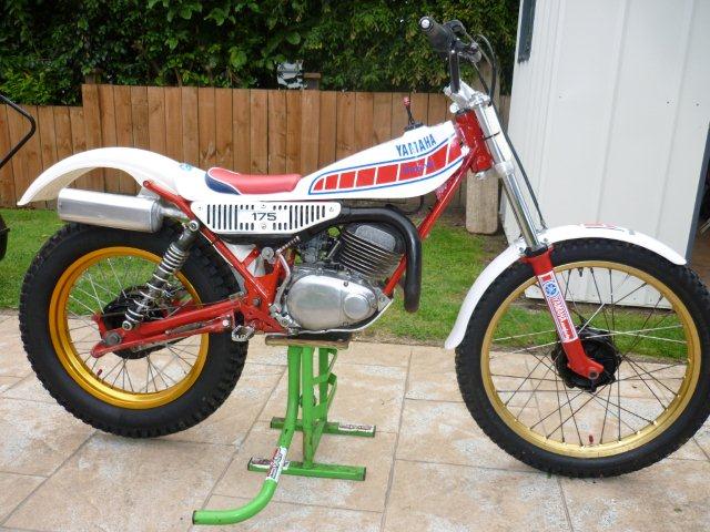

Hi, I have used a Gasgas 36 spoke outer rim along with standard TY spokes to convert my Ty175 Majesty to tubeless. You have many tyre options and can run low pressures which gives much better grip. I use a x-light and have had no issues in the last couple of years.
- P1000850.jpg (70.77 KiB) Viewed 7424 times
- P1000852.jpg (69.4 KiB) Viewed 7424 times
