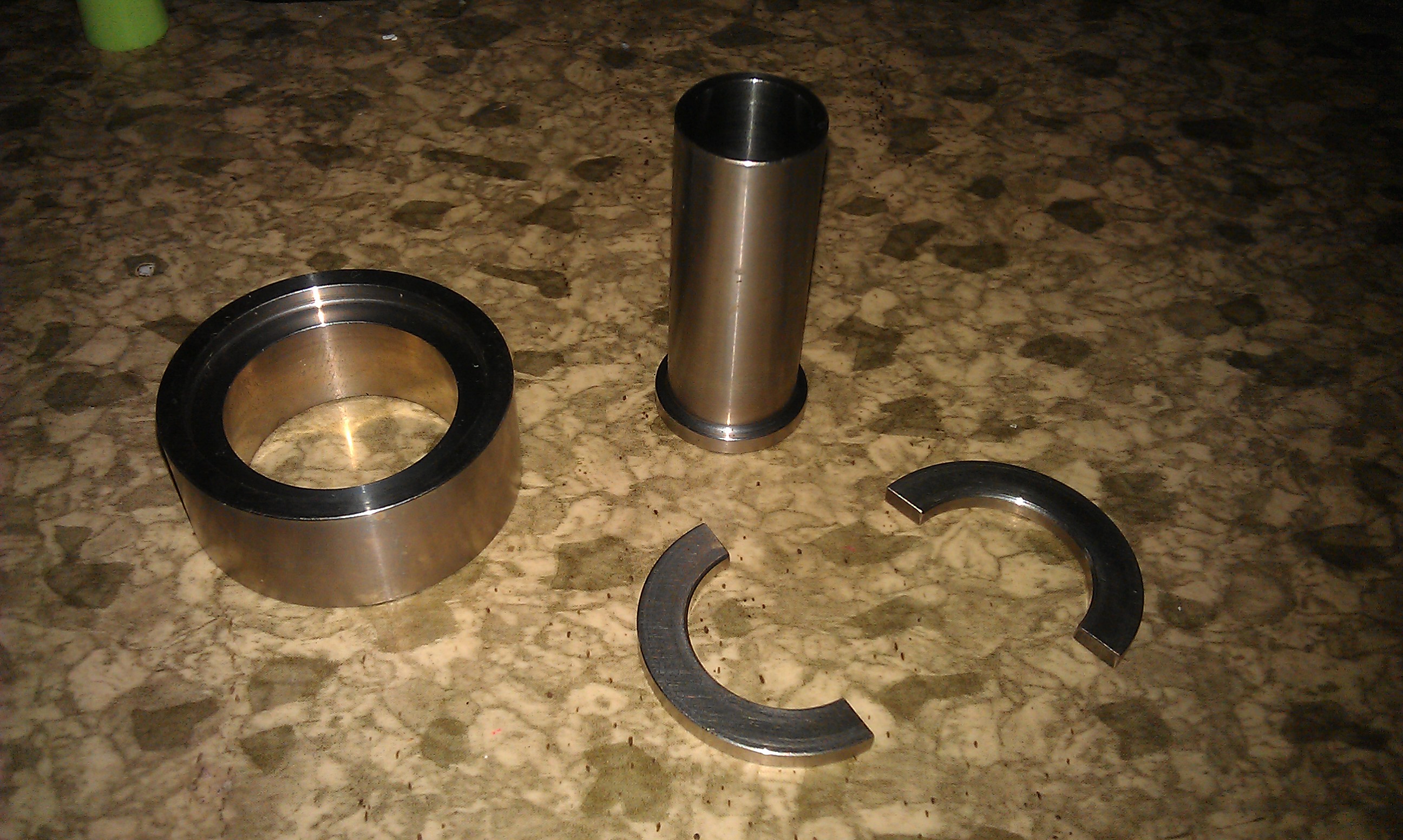

Another thing about pulling the cases apart Tony, the primary drive crankshaft sprocket is mounted on a cush drive device that is supposedly tricky to remove from its taper. I don't know how successful it will be, but I bought a special puller from Keith Lynas for the job but haven't tried it yet. There may be better ways to get the cush drive off and mentioning this might prompt people to suggest them.

Re: Ossa Explorer Questions
Mainly for Tony's benefit, here is what the OSSA primary drive cush puller looks like. I'm thinking that the bigger pieces fit behind the cush drive hub and the smaller diameter piece fits over the end of the crankshaft. Ah the joys of working on OSSAs
