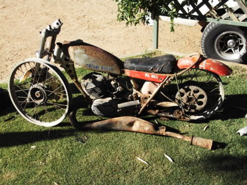

So...bought this for $650 18 months ago, complete and fairly good apart from the obvious missing tank and frame colour.
Already had a 520 chain conversion, new tyres and was running well despite being un-used for 10 years. Checked that it selected all gears ok and proceeded to pull it apart for a basic fix up.
Started 2nd kick after sitting for the last 18 months and still runs great, rode up and down the lane a few times (furthest I've ridden it) and was surprised at the power - these things haul for a trials bike!
Only downside is the damn font sprocket I ordered to fix the gearing is wrong, so first ride will be with the terrible 13/39 gearing it came with. Feels like it will do 100kp/h as it is, so there will be lots of clutch work for the time being #-o
Then I found this which I bought for $300, used the parts I could and it was worth it for those
A few bearings, some paint and more dodgy repairs ensued, and I ended up with this:
Too poor to restore the tank and it will only get dented anyway, so it stays as purchased with maximum patina... Yes it looks stupid (as does my backyard engineered galvanised sprocket cover) but I actually kind of like it :D

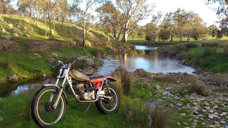

As promised some pics of the RL in action for the first time.
Runs and rides really nicely and, apart from some minor issues, tackled a variety of tricky stuff with ease. Was impressed with the power and it's smooth and tractable delivery, and generally the bike feels very well balanced and turns really well. This was the longest I've spent on a trials bike so far, and it took my endless clutch work, mono attempts and trail riding antics brilliantly.
Main problems are soft forks, pathetic front brake and the gearing. It also gets a bit rattly when warm, although it was 30 degrees and was ridden for up to 20 minutes at a time.
The 13/39 gearing was funny - one photo shows a beautiful spot which was 7 kilometres from the block on quiet country dirt roads. I didn't have a trail bike and it was either the RL or my mates CT70 Honda, so I wisely chose the RL despite the CT70 being road legal. At one stage we were cruising at a comfortable 75km/h, and the RL was hardly breaking a sweat. Reckon it would have hit 100 easily which would no doubt be quite unnerving on a trials bike...
Also, and unsurprisingly, my precious fuel tank sprung a leak. Nothing too bad, and considering the condition of that basket case I bought I'm surprised it held fuel at all.
80 acres of undulating trials heaven with 1km of river bed, a dam, big rocks, cliffs and more! Very dry though...bring on winter!
Enjoy the pics!

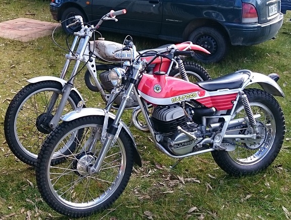

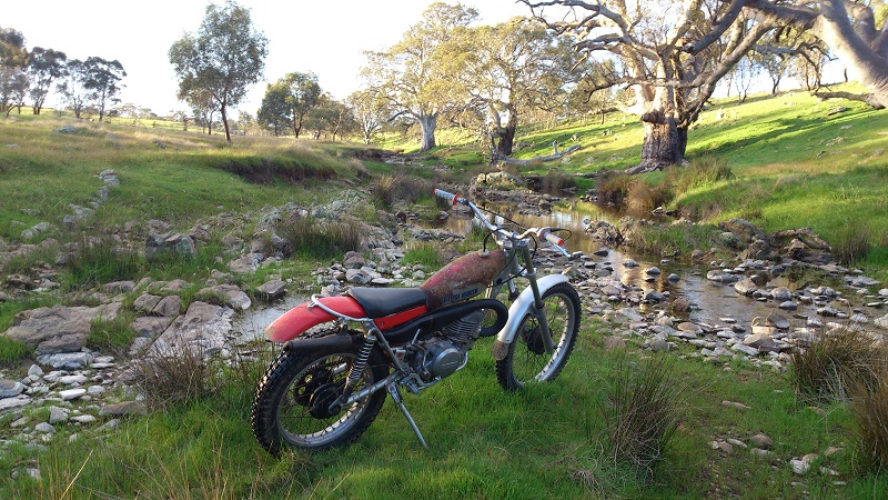

Went camping in freezing weather this weekend - was snowing 50km's away at Mt Lofty.
New brakes and new gearing sorted, now running a 45T rear with 11T front which has made a massive difference. Thanks to Paulo for the advice on the 11T front - it didn't rub on the engine case all weekend, and after copying his nylon chopping board swingarm guard there is no chain rub anywhere.
I really loved riding this bike before, but the new gearing has transformed it - I was able to tackle some fairly gnarly stuff this weekend which I haven't even looked at before. I'm considering entering my first event after some more improvements to the bike, but essentially it's now quite well sorted and working very well. So reliable - have probably clocked up 20+ hours on this since building with no major issues, just normal servicing and maintenance.

Very nice, and that Bultaco looks fantastic. I would love to find one of those, want to sell it?
Re: RL250 project and other pics for your amusement
Posted: Mon Jul 13, 2015 7:44 am
by i-moto
The Sherpa belongs to a friend of mine and no, I don't think he'll ever sell it unfortunately! Several of us have asked already... Such a nice machine to ride.
