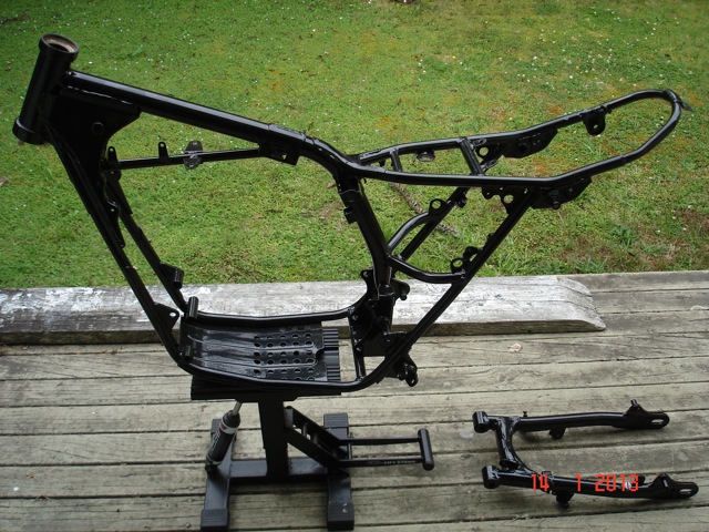

Hi, Next step. Just finished getting new bash plate fabricated as original was rusted out. Thought about widening it to protect side covers but decided it might hinder installation and removal of engine. As close to original as i could get, right down to the number of holes :mrgreen: . Frame is now off to media blasting and powdercoat. Cheers Ross

Hi, Frame back from powdercoat. Decided to go with a white frame. Why? 1. Influenced by Scorps goer :D . 2. Trinny and Susanah tell me that wearing black looks heavier (anything to try to reduce the weight of the green pig :mrgreen: ). 3. Because i can :twisted: Cheers Ross
