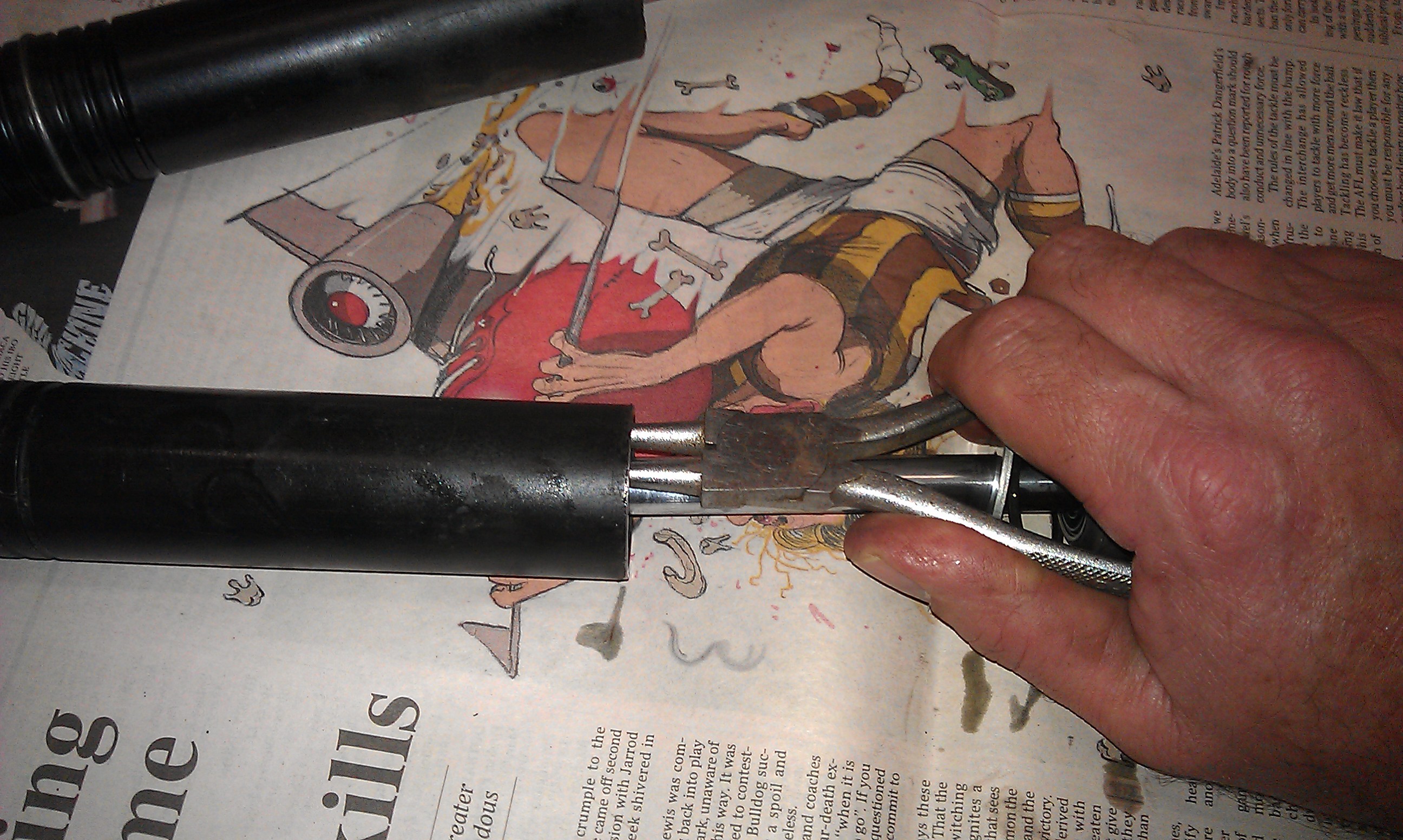

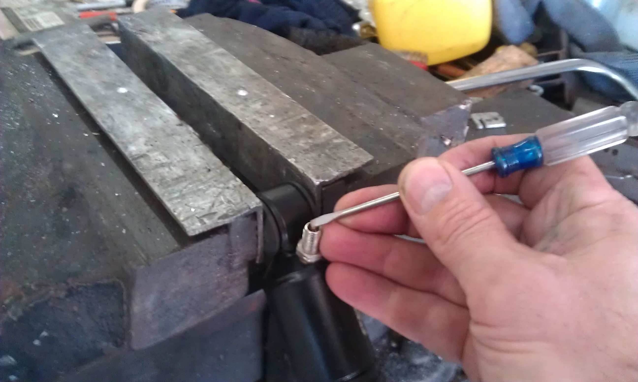

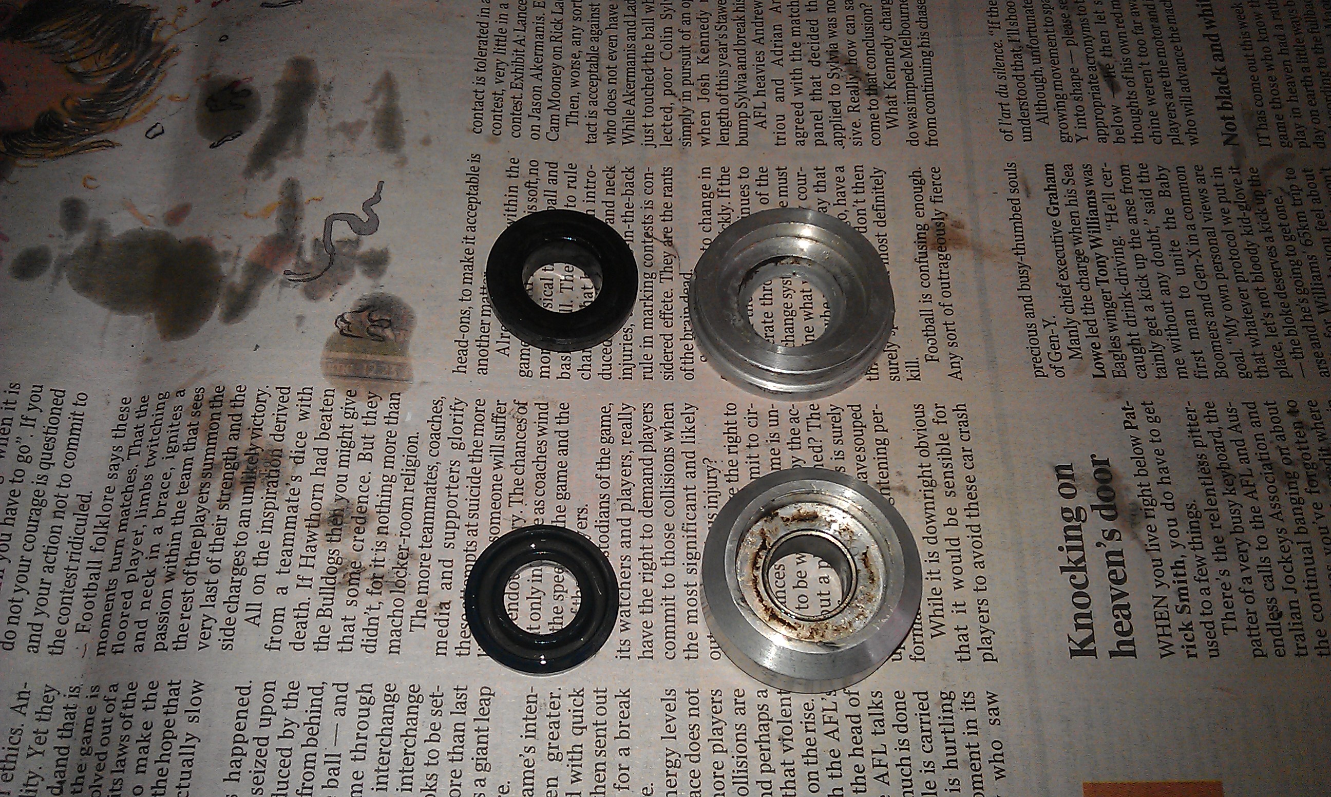

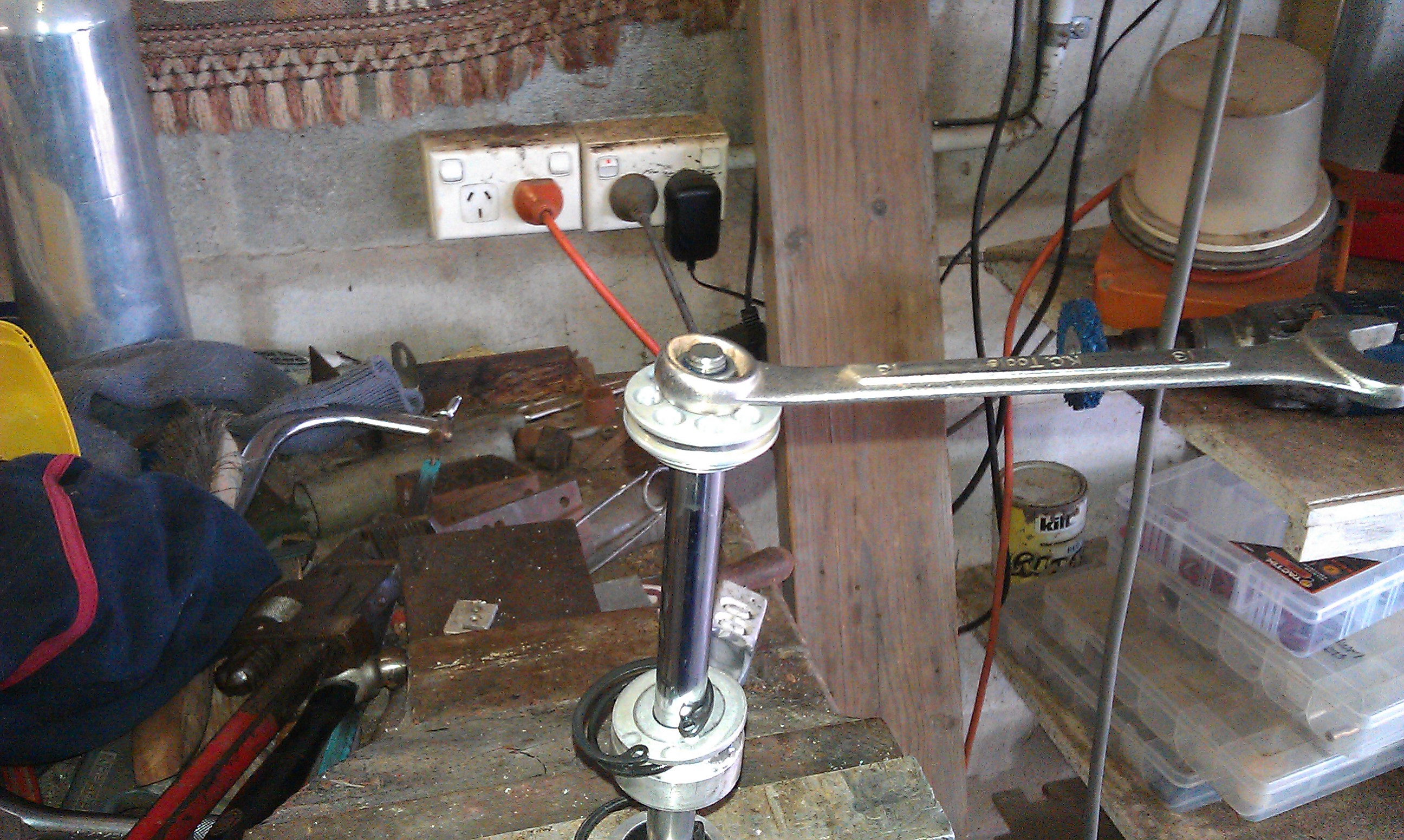

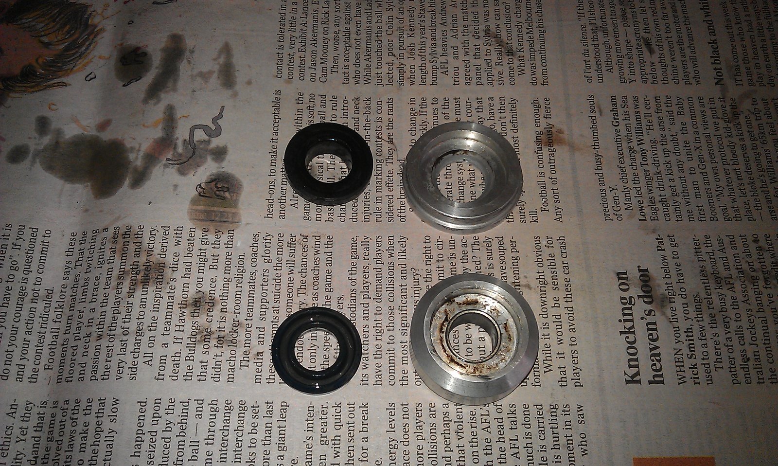

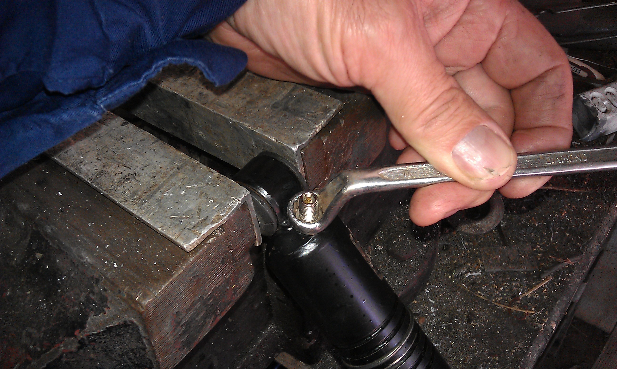

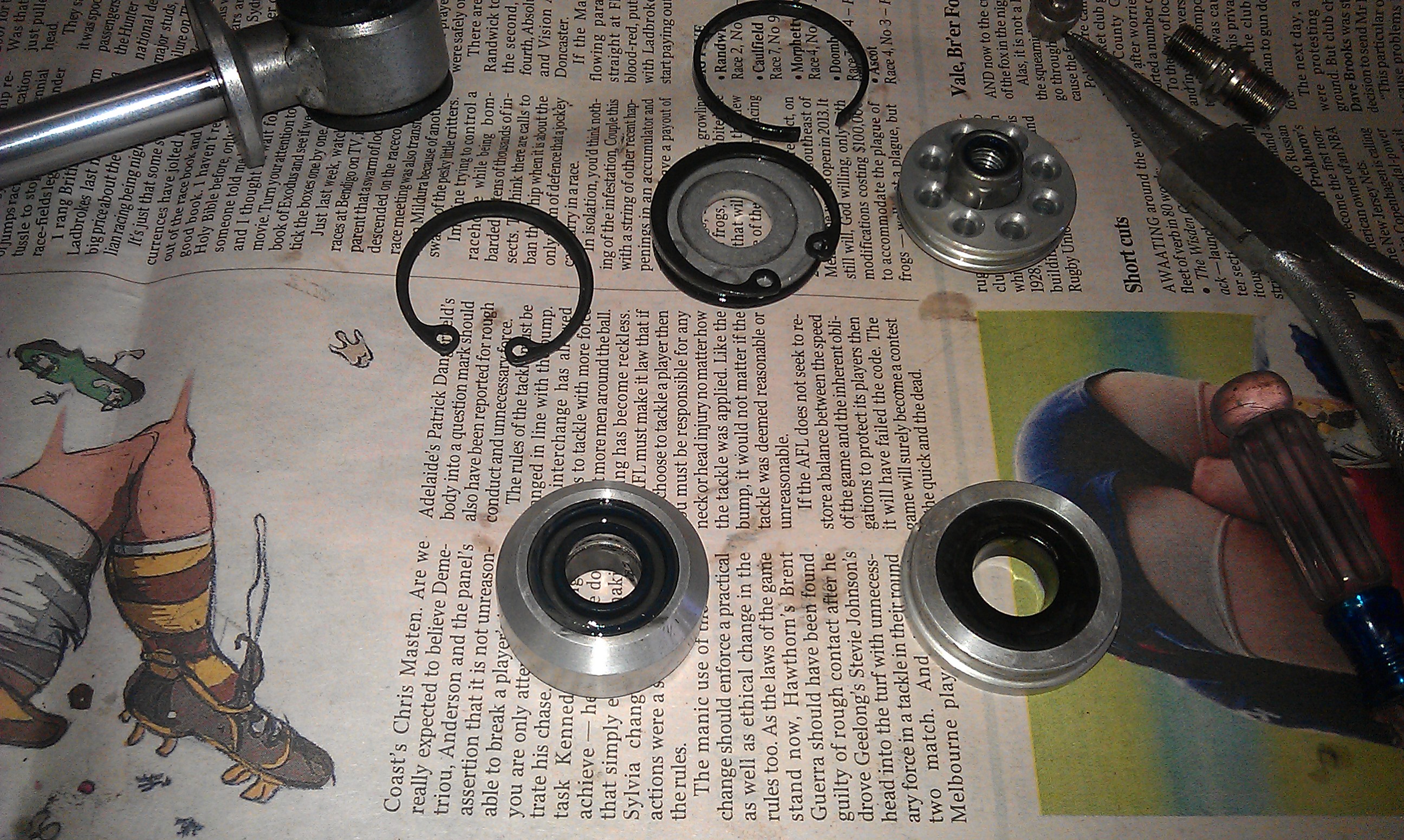

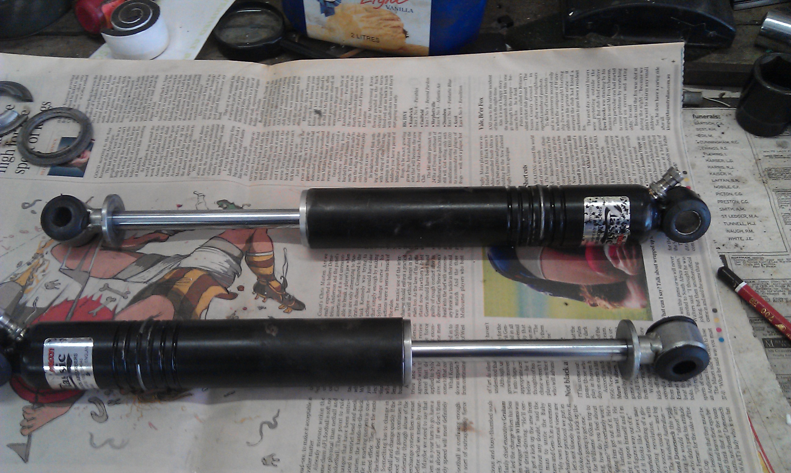

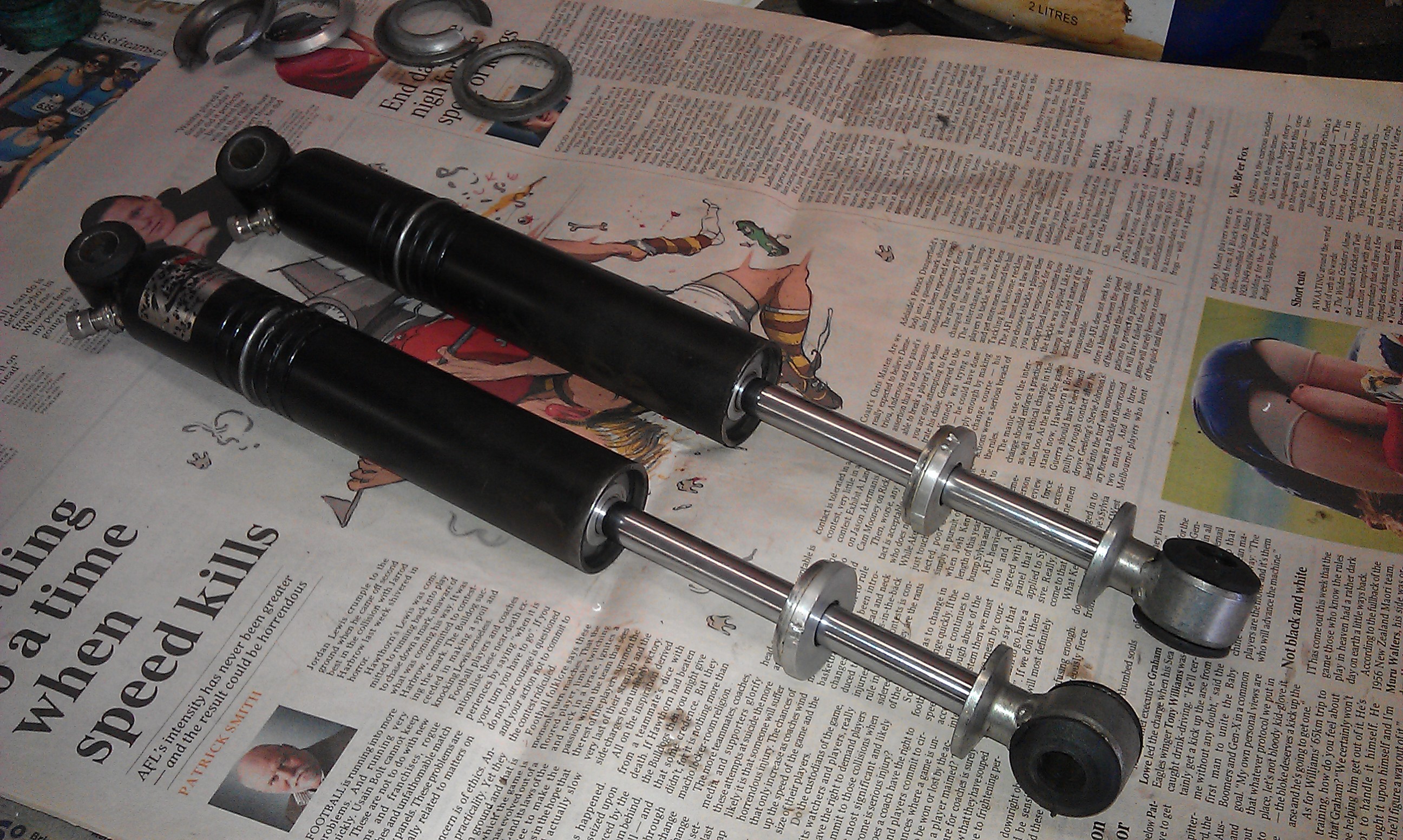

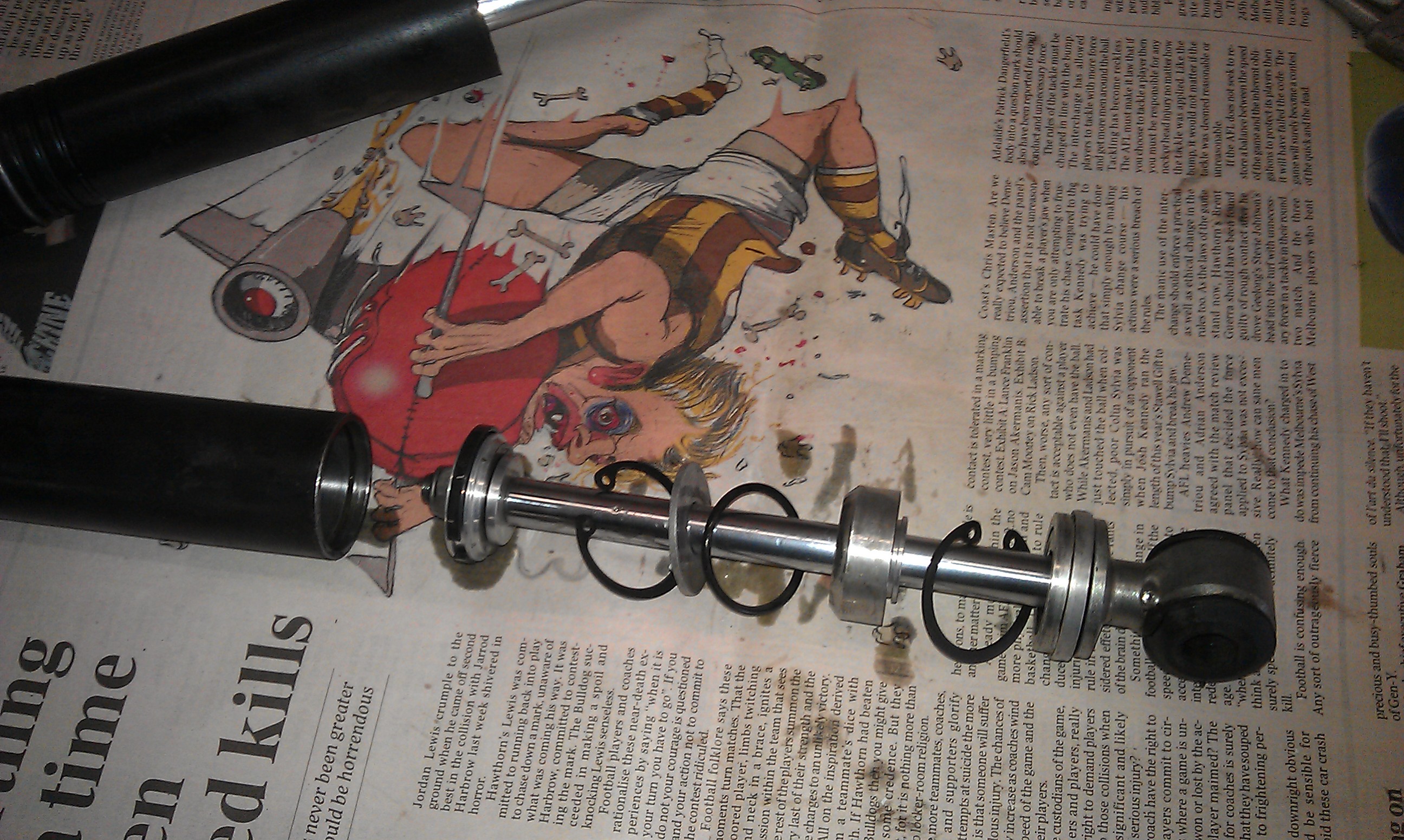

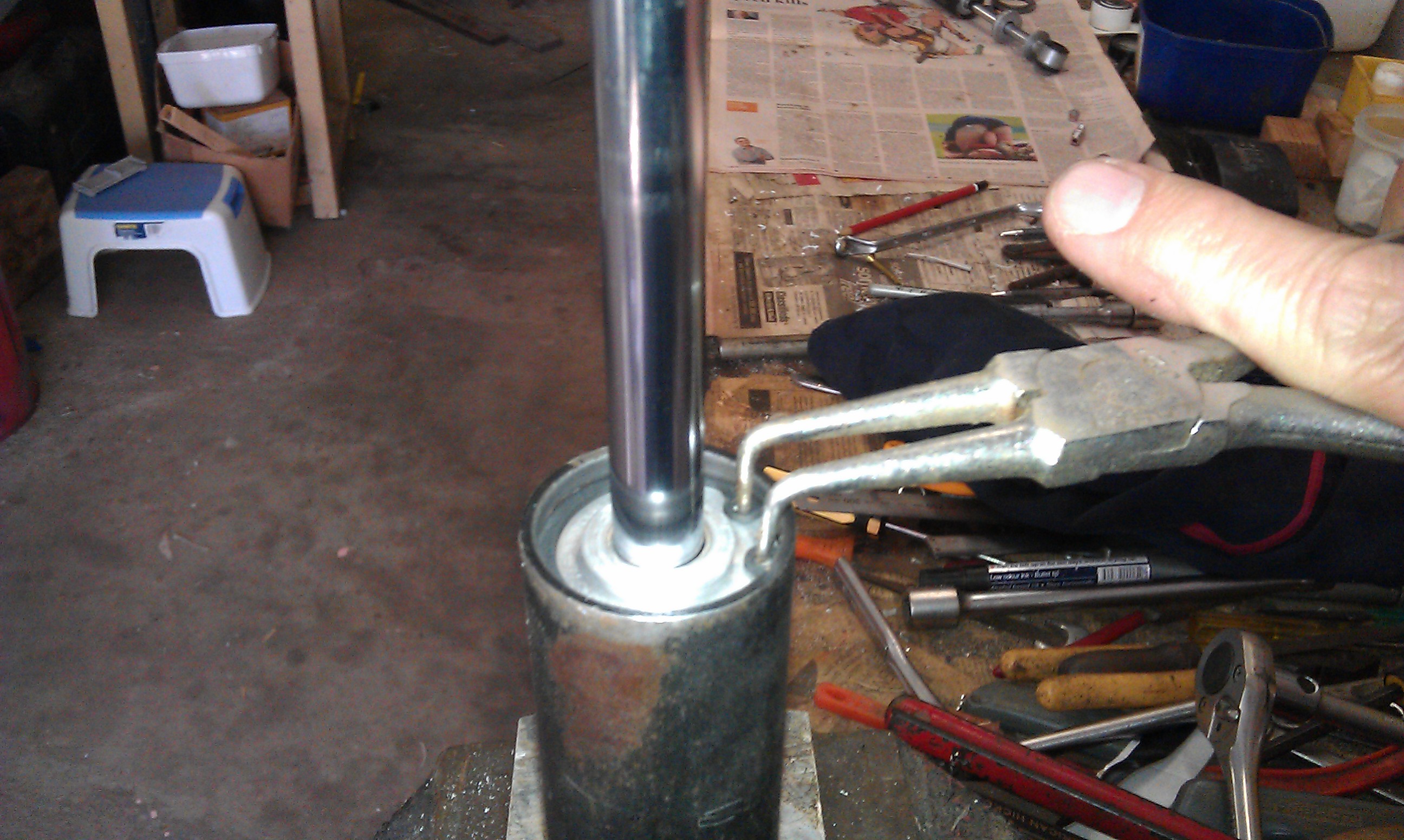

Photo sequence showing a Falcon Trials Classic shock coming apart in case anyone wanted to see inside one

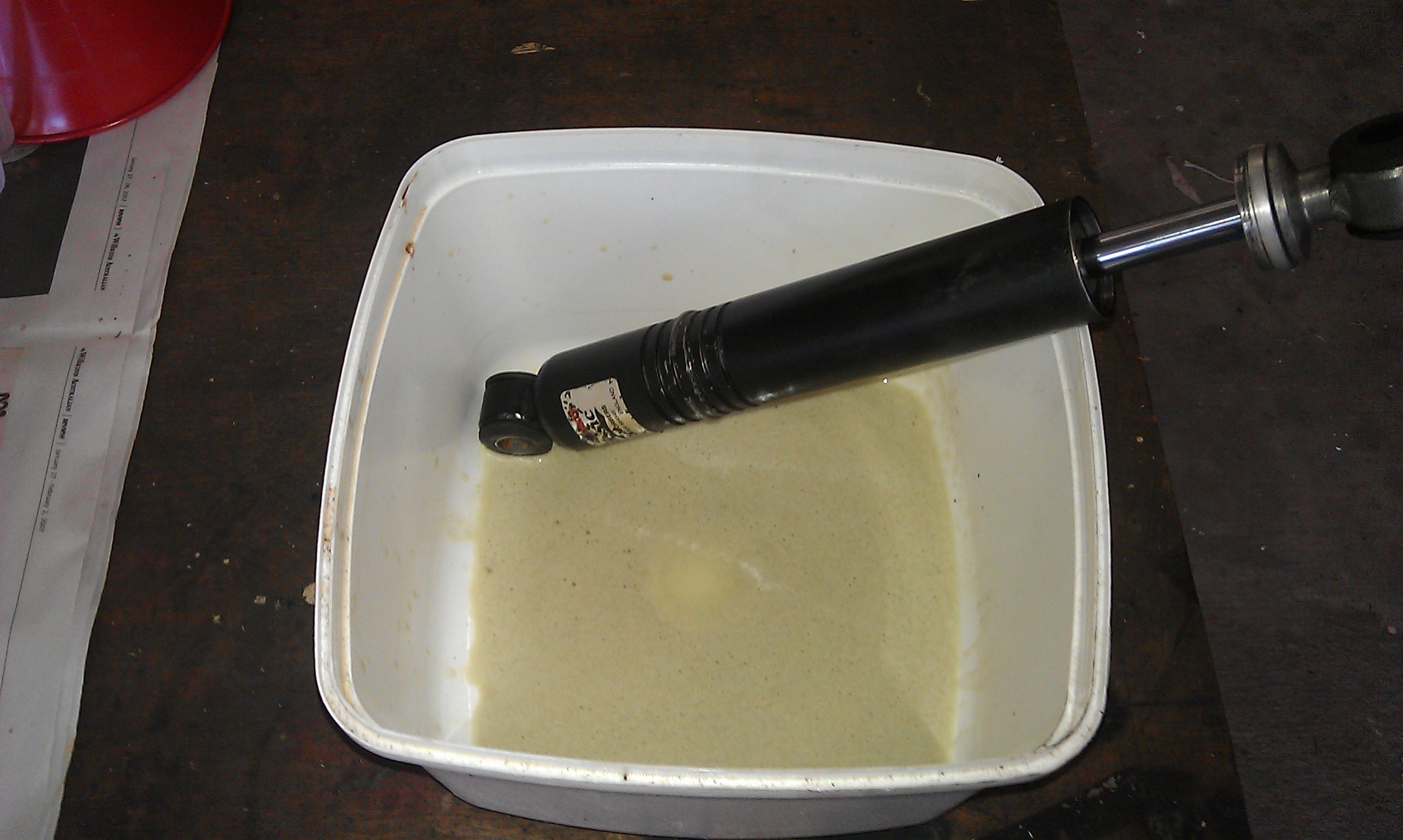

I use compressed air at about 70 psi. Can't see what the type of gas has to do with topping out problems. The only thing that using air should do compared with nitrogen is to cause the oil to degrade a bit quicker, due to the oxygen and trace amount of water in the air. Was there anything else different after the rebuild compared with before ie oil weight, oil quantity, spring preload? I would be interested in what is found with Geoff's shocks when he works out what went wrong.
The shocks in these photos went back on the KT with 100ml of 10wt fork oil in each and got a severe hammering this afternoon on my practice sections and they worked fantastically.

Just something i noticed in your pics Dave, the dust caps had some marks on them from the tool you used to remove them, I used a very fine chisel almost like a bread and butter knife and popped em off with hardly a mark, no biggy just thought id mention it for others thinking of embarking on the falcon rebuild journey.
Geoff

Thanks for the idea about using a chisel on the dust seal holders. I wish they made them with a recess to make it easier to get them off
