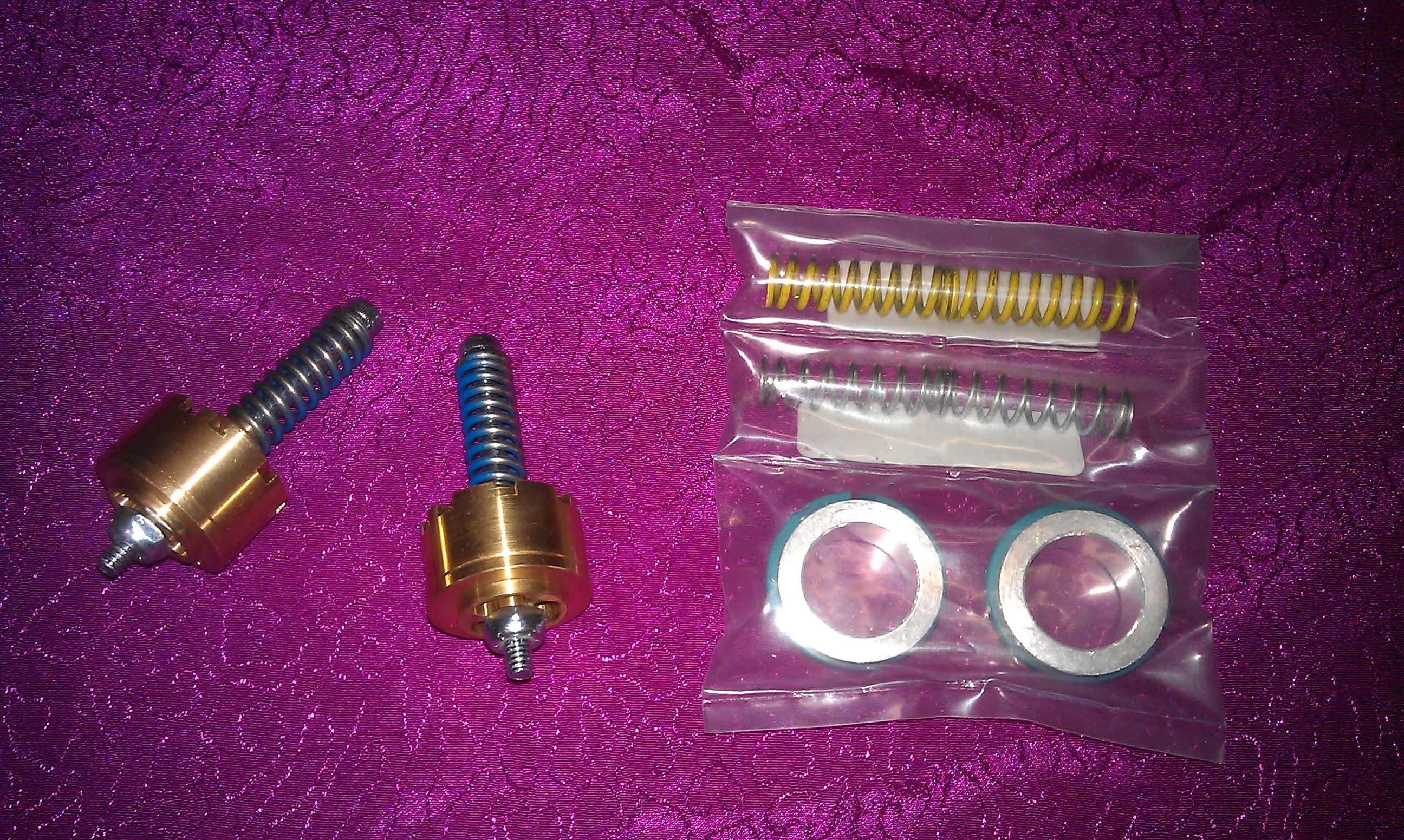

I've been wanting to try a set of cartridge emulators for quite a while, and finally gave up waiting for someone else to give them a go in an old trials bike.
I bought a set of Gold Valves last week and have just fitted them in the TY250D forks that are on my Godden 250 Majesty.
They are meant to make the compression damping rate-sensitive, and to achieve this they use a spring loaded valve that opens relative to how fast the forks compress. They don't change the rebound damping. Standard 1970s forks have fixed size orifices for compression and rebound damping, so the compression damping is a compromise between resisting bottoming during slow compression, and not being too harsh when the suspension is compressed quickly.
So far I have tried them with the standard settings on the Gold Valves, and 15WT fork oil, standard fork springs and 50% sag, and there is a noticeable improvement in the way the front end feels when riding rocks. When I have done enough testing with these standard settings, I'm thinking of trying heavier oil to increase the rebound damping

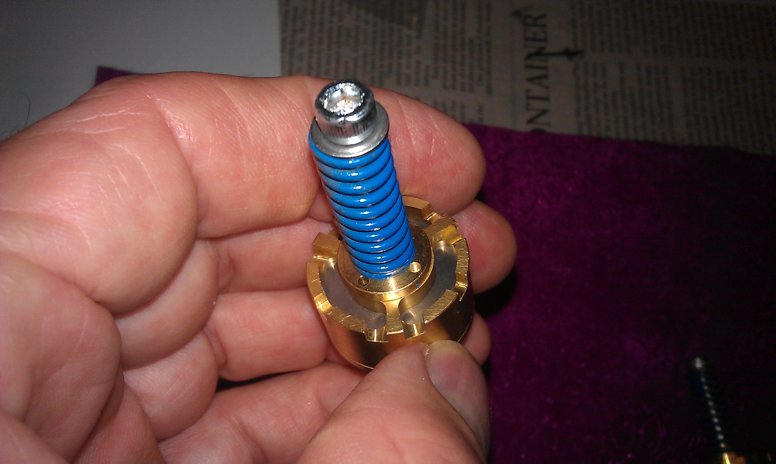

I've been doing test'n'tune with the gold valves today and just like Steve and Izzy found, backing off the compression damping is the go. Standard pre-load on the gold valve spring was 3 turns and I ended up on 1 turn of pre-load and very happy with the results. Still using 15WT oil, 50% sag and standard springs.

G'day David just reading your first post& i'm thinking you didn't drilling the existing compression holes any bigger or add any more hole as it says in step 3 of the gold valve instructions or have i miss read you, i'm going to play around with mine soon as well will back the spring off then try light oil & what ever else i think might work
Posts: 4118
Re: Cartridge emulators for 1970s forks
eagle wrote:G'day David just reading your first post& i'm thinking you didn't drilling the existing compression holes any bigger or add any more hole as it says in step 3 of the gold valve instructions or have i miss read you, i'm going to play around with mine soon as well will back the spring off then try light oil & what ever else i think might work
I did drill four extra 6mm holes, making six holes in total and I cut off the tops of the damper rods. The only place I deviated from the gold valve instructions was I didn't remove the centre section of the roll pin.
