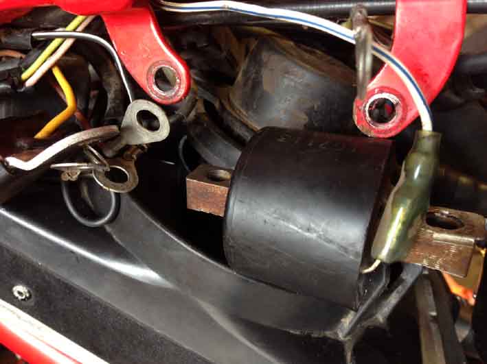

Hi my names Glen and im a newby to trials and loving it. Buuuut Ive done this without paying attention to the order of connection with these eyelets, its a 2011' GG Text Pro. Please help me here im really stuck..

If they are all earths, as they look to be, it won't matter at all mate. As long as they all go on the coil and battery terminal and then to the frame, the order will not matter. :thumb:
Edit as I meant to write frame there, not motor!!!

There should be five wires that are all "eye" connectors that go on the coil mount closest to the headstem. Any order (as long as it's neat).
I have drawn you a simple mud-map to follow below. Again if you are stuck give me a call.

Thanks guys i did whatu said just by chance this arvo and it all works! Stoked and im on it for this weekend!
