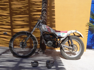

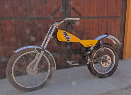

Below is a picture of the bike before the work began. I started a blog to keep myself and the project) organized. I've gotten quite a few hits from the guys at the Trials Central Forum in the UK. I've also noticed a few hits from you guys down under. So, here is a link, if you care to follow along. http://meditarivemachinery.blogspot.com/

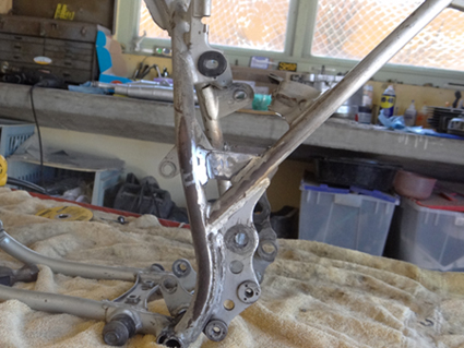

Since my last post things have been happening. I know that you guys are having your winter whereas those of us in tropical Mexico are having an especially hot and humid summer. Today when I got up it was 87 degrees inside and 95 degrees outside...now it is 110 degrees outside and 100 degrees in my "shed" as you guys call workshops. The humidity is right at about 50%. So...work has been slow. Yesterday I got the frame back from my good friend Chuy. Attached is a picture of his work around the swingarm pivot.
Prior to welding in these new reinforcing pieces (same piece is on the other side) the frame had one perforated piece on the left side and nothing on the right side. So, now the frame is significantly stronger in this area, and it is at least the same on both sides.

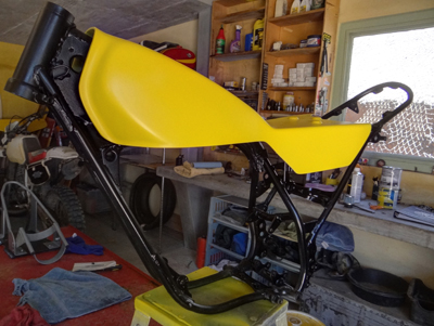

This is just an up-date on the Mexican TY. Painting has begun. In a short time we will have a finished bike. Better pictures and commentary on my blog

More progress has been made...despite the overwhelming heat of our summer here in tropical La Paz. It is true, we have an El Nino condition in the Eastern Pacific. The new result is a lot of heat and humidity and an almost daily formation of one or more hurricanes off the Western Coast of Mexico. It's only a matter of time before we get a few...Anyhow, I put a couple more clear coats on the tank/seat unit and then I was able to decide which of the Yamaha decals looked best. I'll finish the chassis as time/energy permits and then I can see if it will start.
You can also see in the background that I've started painting the seat/tank unit on the TLR
More pictures and description on my blog at:
Thanks for looking...
Mike

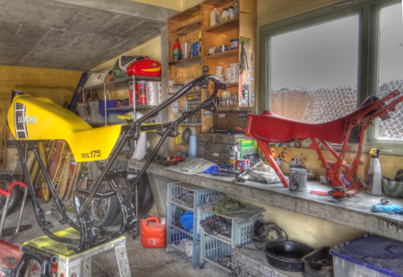

Another up-date from Mexico. We are starting to get close now. The paint and decals are on, and I found the time yesterday to put the chassis together. Mainly I wanted to see what it would look like with the new paint scheme and the alloy fenders. I have to confess, I am very happy. I wonder if Sammy Miller could be persuaded to add a little color to his seat/tank unit?? Probably not, he seems pretty "Old School".

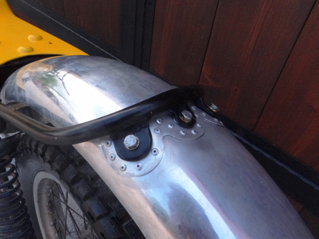

Below is a shot of the rear fender mount. Again, it's not the sort of TY that you would typically see at a Vintage Trials event. However this bike is going to have a very different life.

More and better pictures and a bit of description at my blog. Please take a look. It might change your idea about what a TY ought to look like. Hope to see you...
Mike
