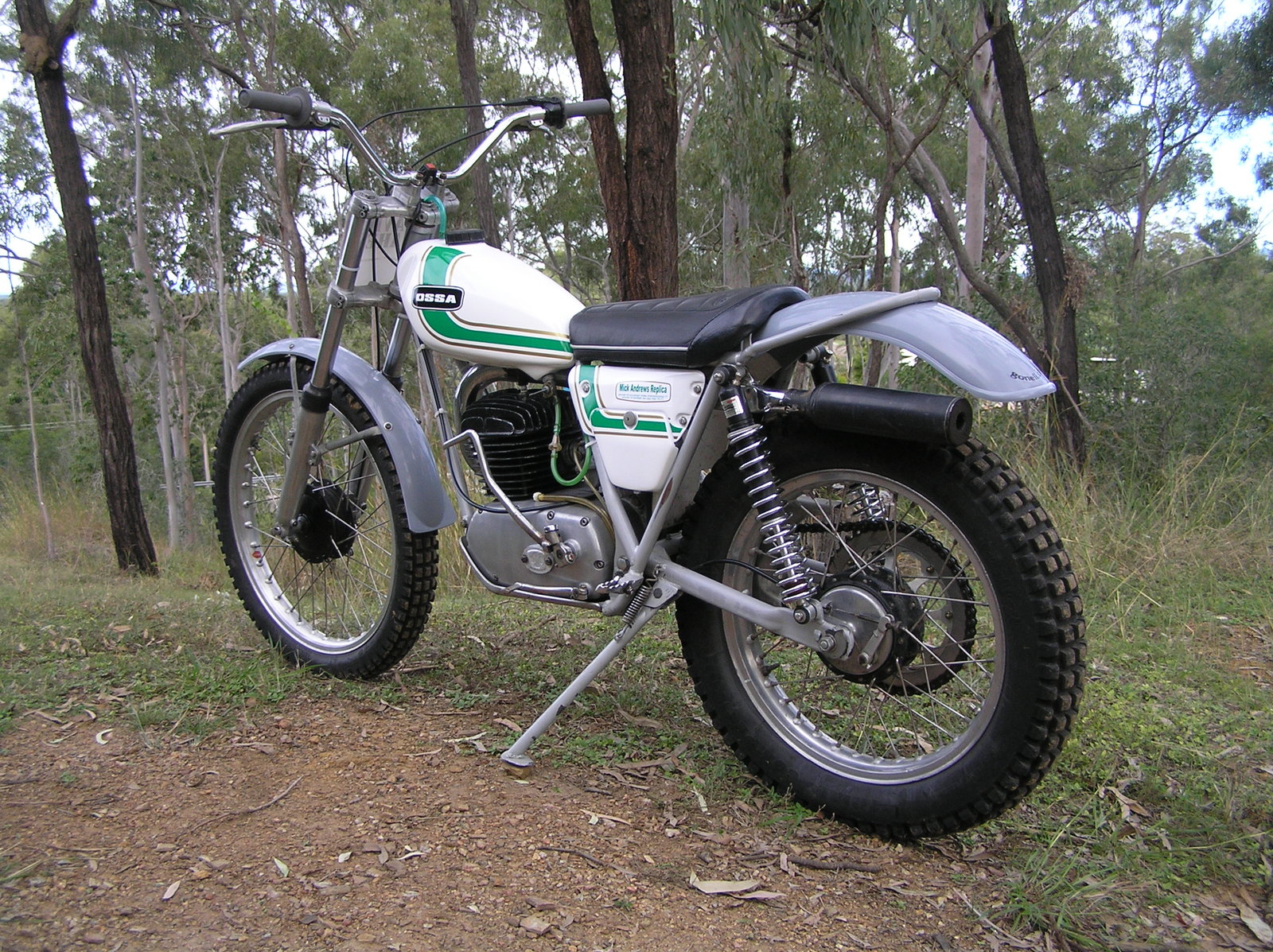

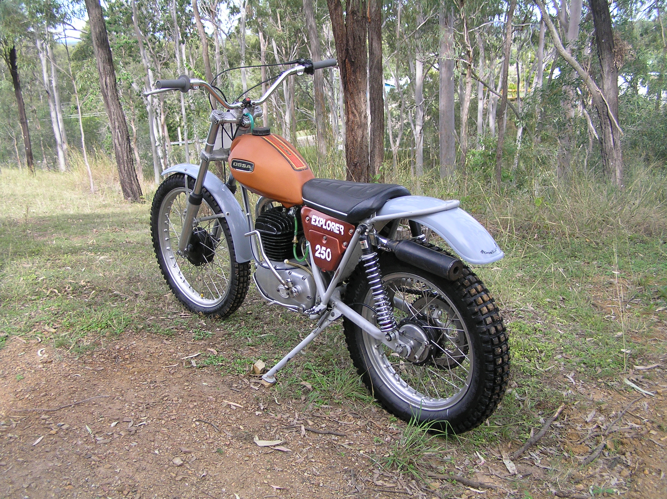

Re: Ossa MAR '74
here's what I'm bringing to Conondale in November, haven't decided which "look" yet
- Posts: 350
- Club: Trials Club of Qld.
- Bike: GG & Fantic.
- Location: Brisbane Qld Aust
Re: Ossa MAR '74
Very nice, the MAR look for me. That's the stripe setup I think mine should have.
