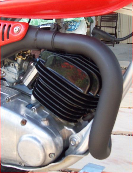

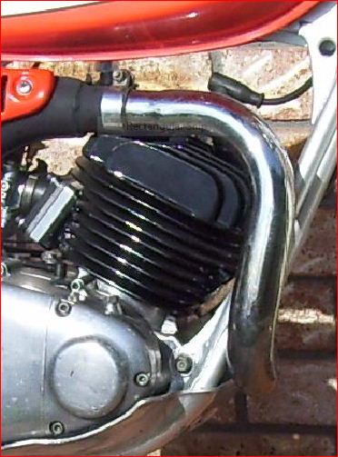

Hi, I have the SM pipe on my TY175 - the SM pipe slips into the muffler, used hi-temp silicone and seals with no problems. See photos attached. cheers, Greg.

60trialer wrote:Hi, I have the SM pipe on my TY175 - the SM pipe slips into the muffler, used hi-temp silicone and seals with no problems. See photos attached. cheers, Greg.

Thanks Greg. Sorry I got your forum name wrong earlier on. Did you originally have some silicone hose as a joiner or am I thinking of someone else's bike?
