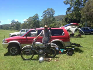

First trial for the Greeves and Myself ( 20 Years )
After 11 sections, a flat tyre, ended the day.
The Greeves ran well, much better than I had thought. And the Rider was looking forward to the second lap.

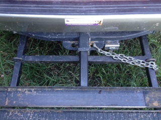

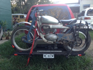

Bike rack on the back of my Mitsubishi work well as well.
Look forward to a few more in the coming year, but will have to work on the legs a bit.
