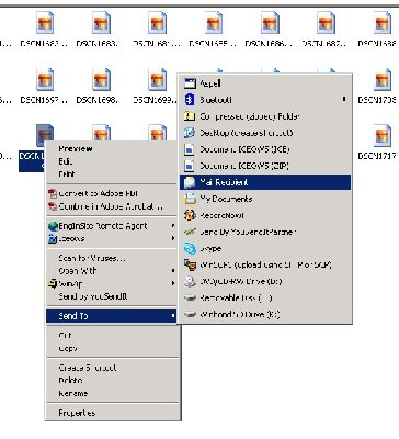

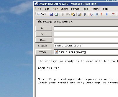

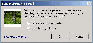

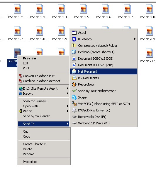

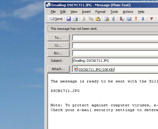

Hi Col,
For that BIG photo, here's trick you might like to try.
Right click the file and select "Send To" then "Mail Recipient".
A pop-up should appear that asks if you want to make the picture smaller...Click OK....
An email window will open....then all you have to do is drag the attached file to your desktop (but not the original folder).
Your new picture will be small enough to post on TA.
