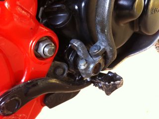

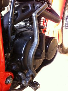

My TLR 200 seems to have the wrong kickstarter fitted . Doesn't fit all the way on the spline and won't close to the detent without hitting the exhaust. Anyone lucky enough to have both (200 + 250)on their shed who could have a look at both models? Not the end of the world but details matter.Rattles a bit and blocks the brake pedal a bit.

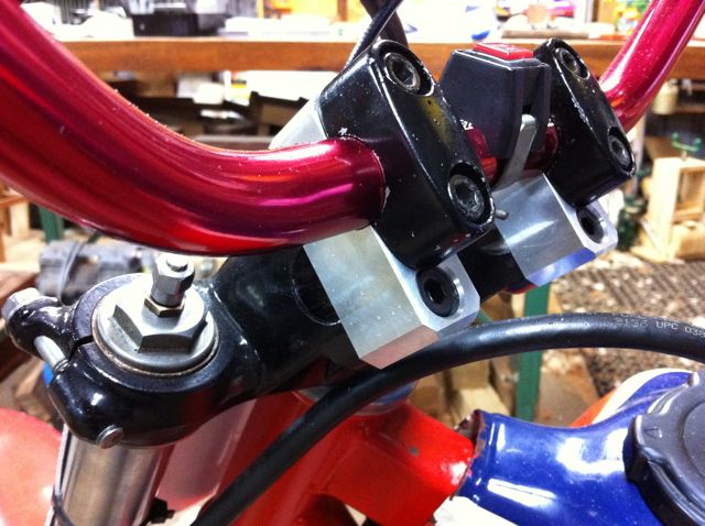

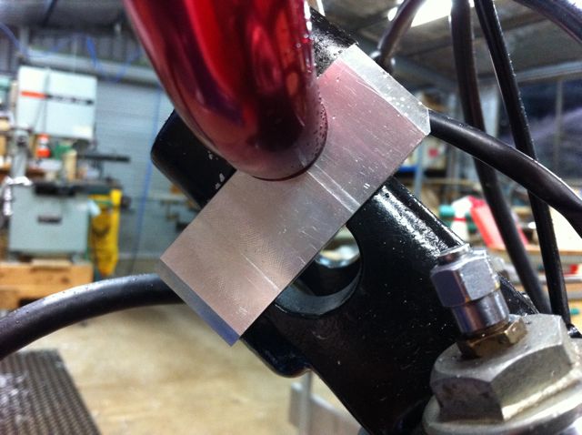

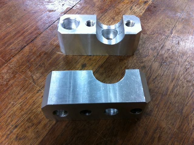

Had some spare time this afternoon so got stuck in to some new bar risers.The plan was to go straight up rather than up and towards the rider.Moving them forward a little is no problem with my height.
May have to spend some time linishing some rounded corners on them to make them look better and then a coat of black paint to make them disappear a bit.
