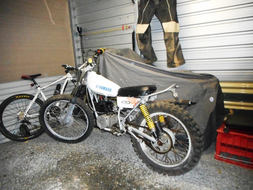

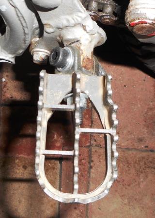

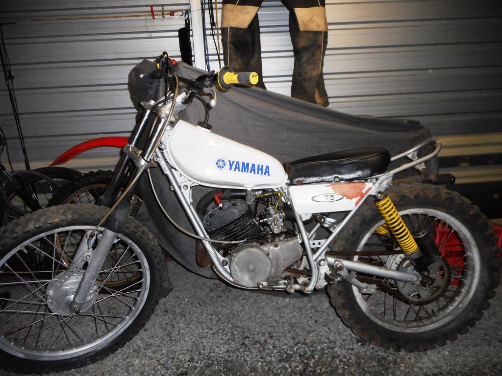

nice looking machine very tidy, mate im in the same boat ,just picked up a 76 ty 175 to do a bit of training and plonking around no comp stuff ,mine is pretty sound mech wise clean motor ,but has all the hallmarks of a classic chook chaser ,ancient rock hard nobbys the gaurds were chalky soft ,mine too has a leaky looking header gasket ,some crazy looking rear shocks ,im doing some mods budget style from old parts I had ,drz footpegs fit with a little tweak ,some better bars I had , got a throttle cable and tube assembly from a pit bike shiop worked a treat ,dropped the forks down as was mentioned ,will change the fork oil tmr,look forwards to your progress ,cheers greg
