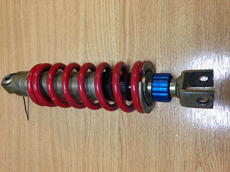

here in the UK I have a after market ty 250 mono rear shock
tyz 1 cv.png (171.58 KiB) Viewed 44576 times

Does a TY250Z shock (assume that is what is in the previous picture given the file name) fit a TY250R and will the spring rate and damping be correct ie is the mono linkage action similar? Apparently, Ohlins list a build for a 1993 TY250z so I am thinking of getting one for my 1988 TY250R.
