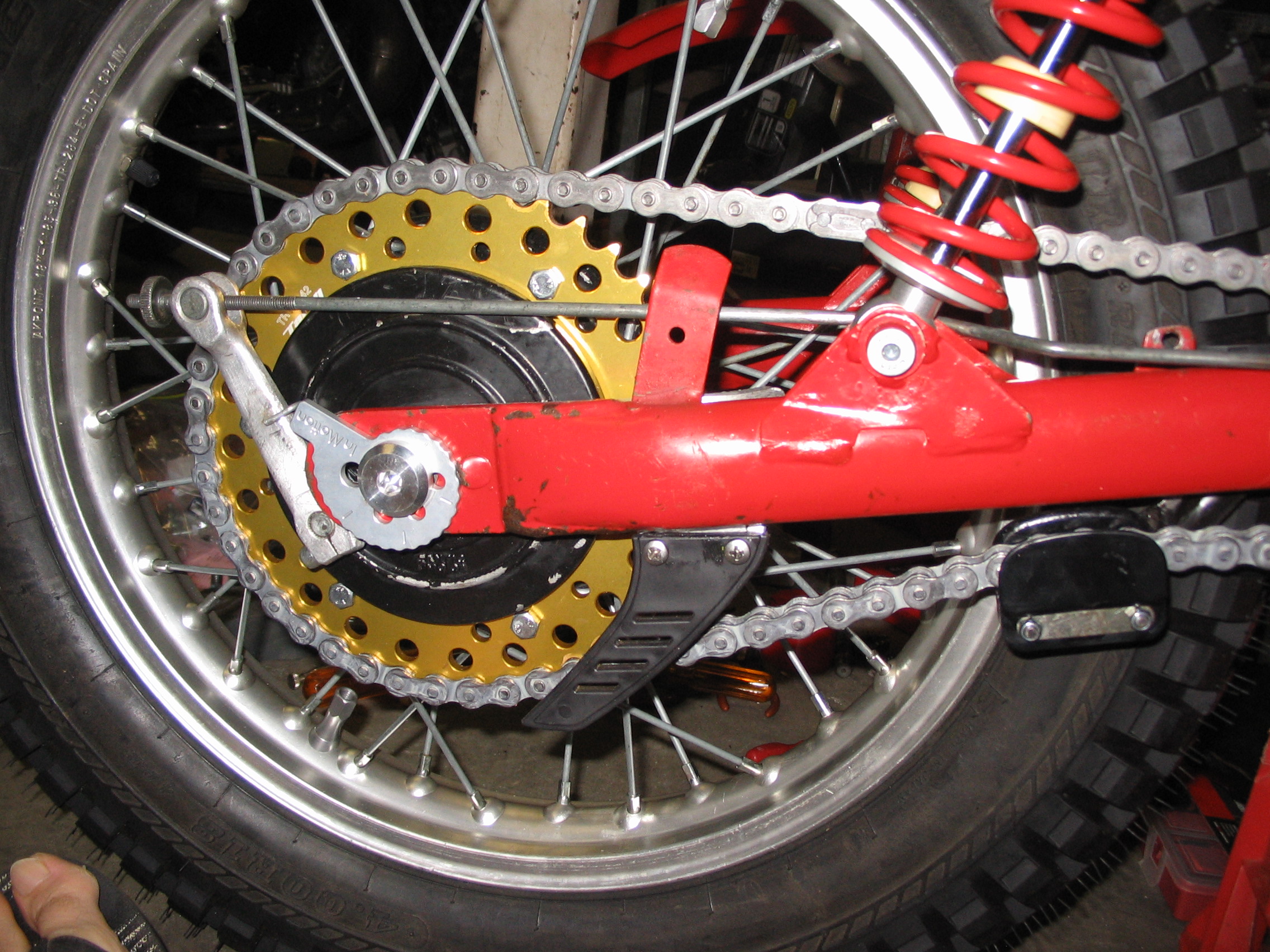

Definitely the lanyard kill switch and rear sprocket guard would be the two things that might catch someone out who is re-entering the sport after many years away. Those nylon kitchen cutting boards or any thick plastic for that matter will suffice for a sprocket guard, many simply cable tie them to the brake stay or swingarm and this seems acceptable.
I really just wanted to show off my attempt at a sprocket guard for my ole Fantic, it uses a right sided Beta "shark fin" and the 5mm thick alloy bracket I made has been expertly TIG welded to the existing alloy brake stay by 'Logan', what started out as an outstanding weld went haywire when the gas was inadvertently turned off but Justins experience managed to save the day and I'm really happy with the outcome, it actually looks like it's meant to be there, like a modern bike. Photo attached.

Noob to trials, what is the purpose of the sprocket guard ?
Re: Scrutineering guidelines?
Phil 850 wrote:Noob to trials, what is the purpose of the sprocket guard ?
It is intended to prevent entrapment of body parts into the pinch point where the chain runs onto the rear sprocket
