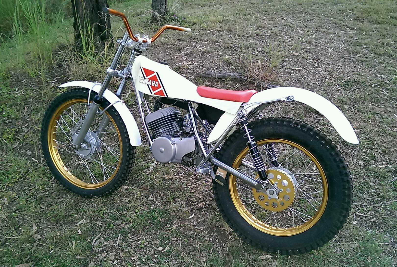

David Lahey wrote:Here is a progress photo of a basket case that has been on the go here for a few years now.
My son Darcy has grown a bit too big for his modern GasGas 50 now and is almost big enough to ride this thing so there has been a flurry of activity around it recently
The frame, tank and seat are Sammy Miller High Boy TY175 made in the early 1980s and the donor bike was a (basket case) TY175JC. The engine has been rebuilt. The rims are AKRONT and were bought along with the frame kit from Sammy Miller Products in the 1980s
It is shorter in wheelbase than a TY175 (about the length of a mini-Majesty)

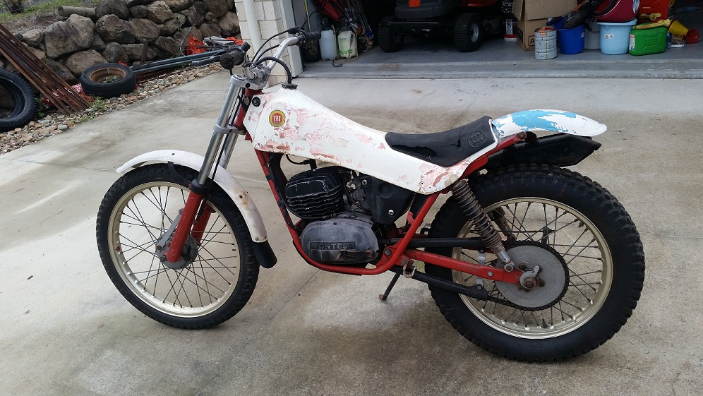

Hi everyone,

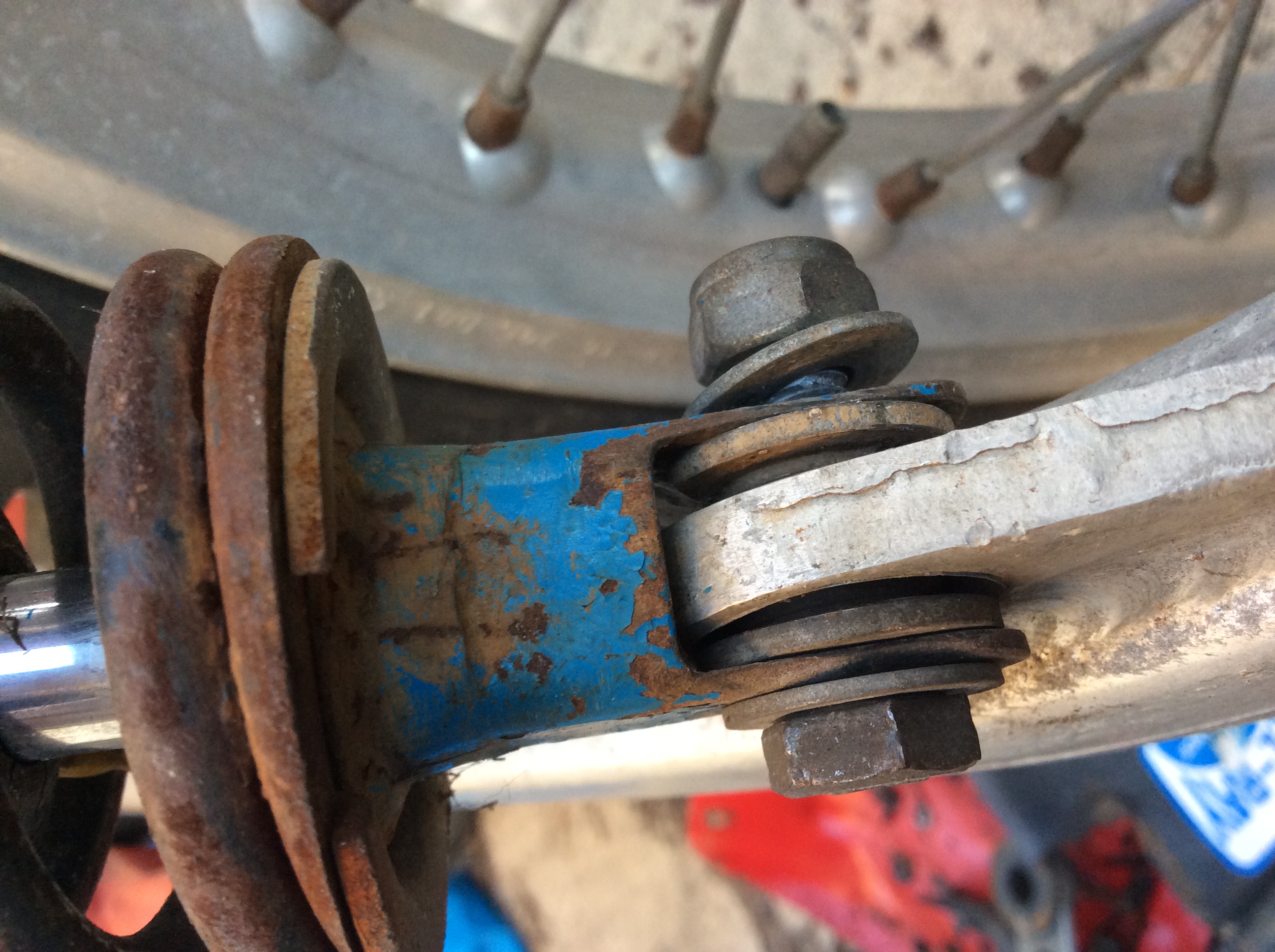

Greg I am thinking that in keeping with a Spanish motor and the fact that you have never mentioned any other "spare" motor other than for a :montesa , my guess is a :montesa motor, but from what and from what year, I have no idea. What wheels are you going to use? Maybe something bigger from that era as I know you like to work on your brakes to work at their optimum and as big as possible.
I will post up some close up photo's of the :montesa 242 swingarm where the rear shocks mount for your information.

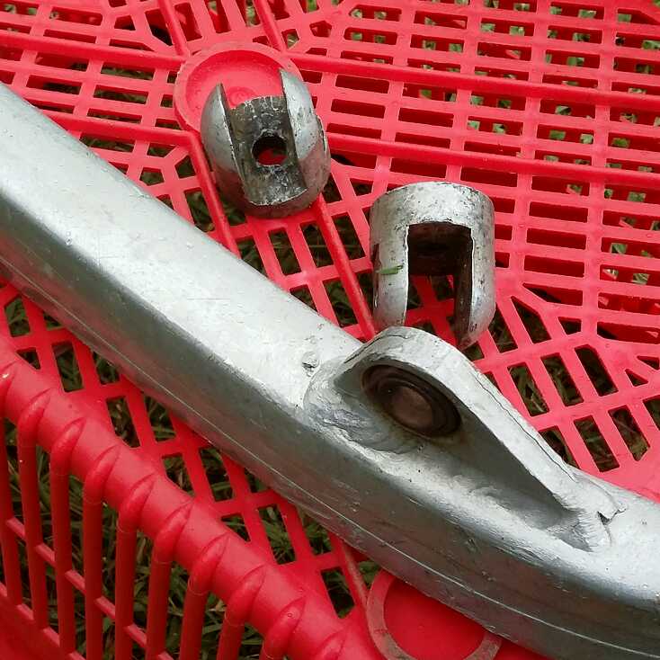

Hi everyone,
Greg I have attached some photos for the rear shock mount on the :montesa 242 for your information.
Chippy

David Lahey wrote:Nice swingarm Greg.
Are those spherical bearings on the swingarm shockie mounts or just steel inserts?
David, yes they are spherical bearings as the top mounts are closer together than the bottom. There is surface rust as you can see in the photos but they rotate freely. There are a lot of parts missing and I will have to make adaptors for the bottom shock mounts, mine must be a different model to Chippys?

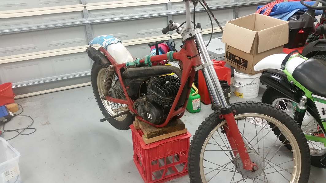

chippy wrote:Hi everyone,
My Montesa cota 200 is progressing and I believe Darren Creswell may have recently aquired one as well. A few photo's Darren?
Chippy

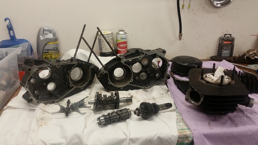

Chippy, the motor is in the too hard Basket for now but I do want to keep this bike all Montesa! As you know the 242 motors have starting issues, namely kick start and kick start gears. This one has none of these parts and I am not sure what happened to the rest of the bike?

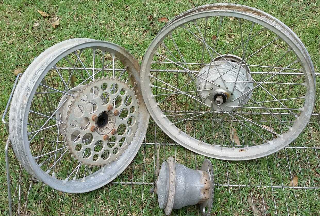

As for wheels, I am going to test some of my theories about rotating mass, a little like flywheel effect. Logic tells me to use lighter later model wheels, however that is not how I do things. With the 242 being around 1985 and close to the cut off date for components, I am going to go back in time to 1976 as I have these Montesa wheels:
The front brake is the same size and the rear is 20 mm bigger than standard, plus the spokes are Stainless Steel, but the main reason is simply that I like the look of them.

Big difference in rear sprocket size between the complete wheel and the spare hub?

witch one is going to the twin shock masters ??
20150912_092707 - Copy.jpg (337.51 KiB) Viewed 8802 times
darrenc
Posts: 25
Club: logan river
Bike: gasgas280
Post by darrenc »
started :oops: #-o
