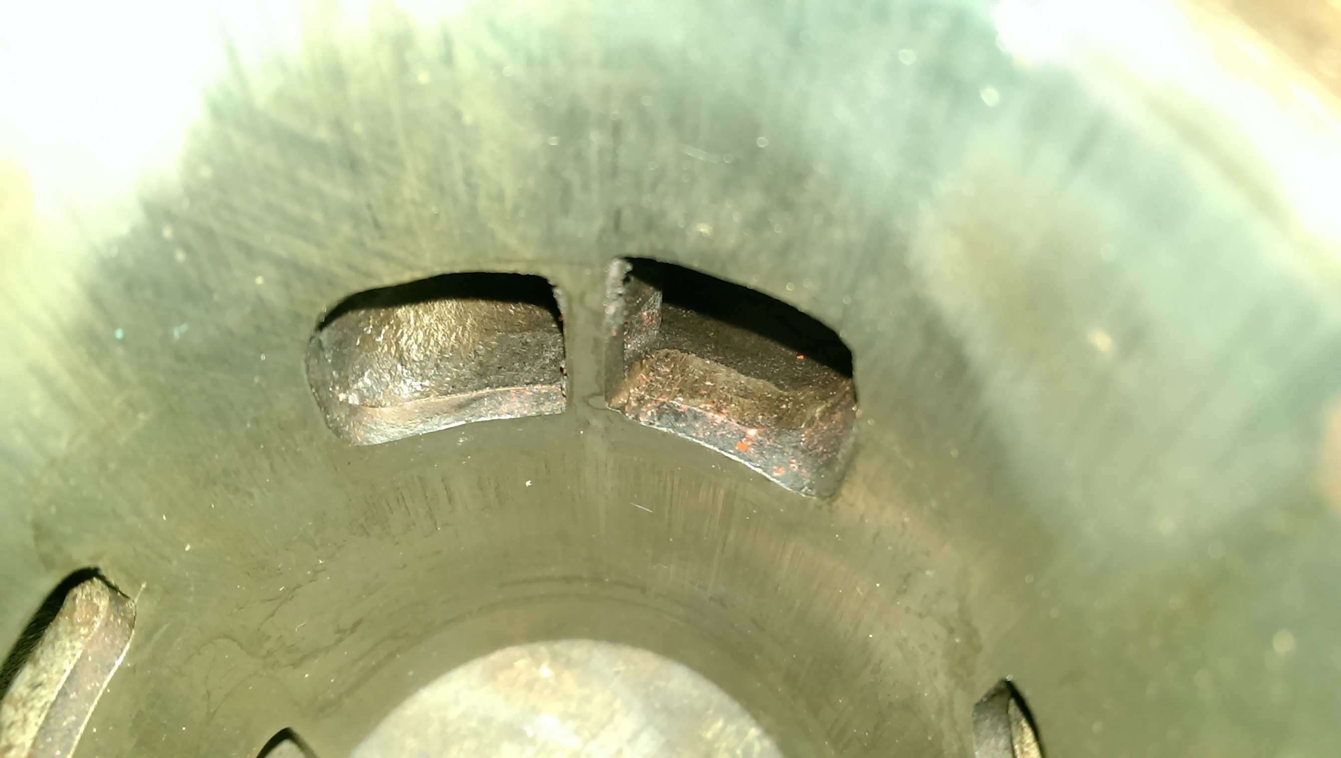

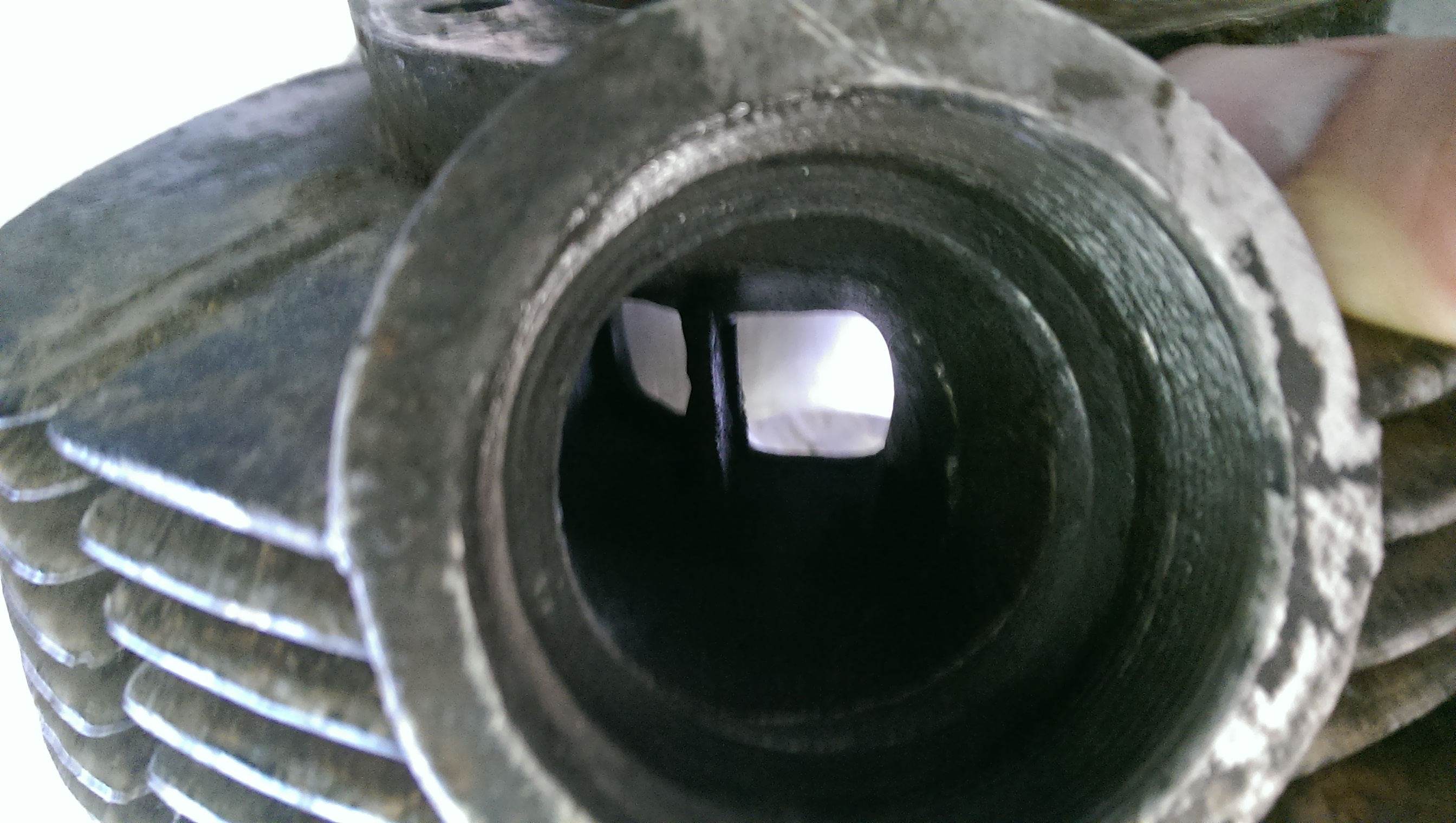

While on the topic of matching or not matching ports in liners to the casting here is a :Bultaco: M85 Alpina cylinder in which someone has trimmed the liner port out to match the cast port, but only on one side of the exhaust port. The photos show the bridged exhaust port from the inside and the outside. In this case the standard side of the exhaust port has a step down of about 3mm from the cast section to the liner, so the side that has been fiddled with has the top edge of the exhaust port 3mm higher than it should be.
Yes that liner is fairly useless.
There are more stories about that M85 basket case yet to come

Dave, what do you reckon they opened up one side of that port by working thro the exhaust outlet, then realized it was going to be much harder to do the other side the same way so just gave up!?

JC1 wrote:Dave, what do you reckon they opened up one side of that port by working thro the exhaust outlet, then realized it was going to be much harder to do the other side the same way so just gave up!?
Seems to me that's a sherpa liner in a matador barrel on the alpina
I'll have another look and see if that explanation about modifying half the exhaust port looks likely John
The factory stamping on that cylinder in the photos is 27, which is the same number as on my current M49 cylinder and also on the barrel that came on my M49 which I assumed was from either an M27 or a Matador or an M49.
I think the cylinder on the M80 I got from you has a different stamping, and I think I read somewhere that the M27 and early M49 shared a cylinder design with the round-barrel Matador, and then the Sherpa T design deviated from Matador design around the time of the late model M49 and M80?
Are you thinking that it is Matador because of the 3mm step down to the liner exhaust port?
David Lahey wrote:Are you thinking that it is Matador because of the 3mm step down to the liner exhaust port?
Yes David that was my thinking. Fair chance they would have used the matador cylinder for the sherpa in those days, as you indicated, and stamped it 27 cos of the different liner used for the sherpas. As I recall the transfer & inlet ports are quite similar on the matadors & sherpas of that era.
As I understand it the M27 cylinder/liner combination was used on all 250 sherpas from M27 to M124. Sounds like it was used on the corresponding 250 Alpinas too.
Yes I had a good look tonight and can see the exhaust port work was done with a file, and there is a carbon layer over the file marks so it was run like that. If they had a porting tool available they probably would have done both sides.
I do have another mystery though because the cylinder that came on my M49 has no ID stamping, and has an larger inlet tract designed for a larger carby than the Sherpa T and Alpina. I had assumed that this was a Matador cylinder because of these two things, but the top of the exhaust port hole in the liner is flush with the casting and measures the same distance from the top of the liner as the (unmodified) exhaust port hole in the liner in the cylinder that came on the M85.
I should do measurements of all the ports in both cylinders
