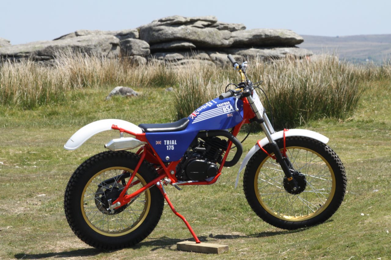

They were used in limited numbers back in the day.Are any of these in Australia ? A mate here owns frame number 007.
- Chapman BSA.jpg (203.35 KiB) Viewed 9109 times
Twinshock200

Is that a bike from Mike Chapman, Stratford on Avon MCC John ??

Jon V8 wrote:They were used in limited numbers back in the day.Are any of these in Australia ? A mate here owns frame number 007.
I've never seen one over here. Have you ridden your mates 007? (cool number). I'd love an informed opinion of what they are like to ride.
Some off-road events over here you have to put a big ID sticker on your bike and I was stoked at one such event to have been given 007 as my number. At the same event the Landowner was a young hippy woman who enthusiastically took photos of her infant son perched on my TY250A because it looked so "retro". I remember saying "it's not retro, it really is old"

Hi Roger, yes the Chapman is the bike Mike Chapman was responsible for. Apparently the first ever production monoshock trials bike. I'd forgotten we had discussed them over on Trials Central;
https://www.trialscentral.com/forums/to ... ent-287740
David, I've not ridden 007, its tucked away in a mates garage,all safe hidden behind a BSA Gold Star and an HT5 Ariel if I remember rightly.I'll have a word, see if I can "borrow" it ! I agree,being a Bond fan,its a cool frame number to have.Might take a while as all of our focus is currently on WW2 army bikes this year as we are off to Normandy for the 75th D-Day anniversary.
