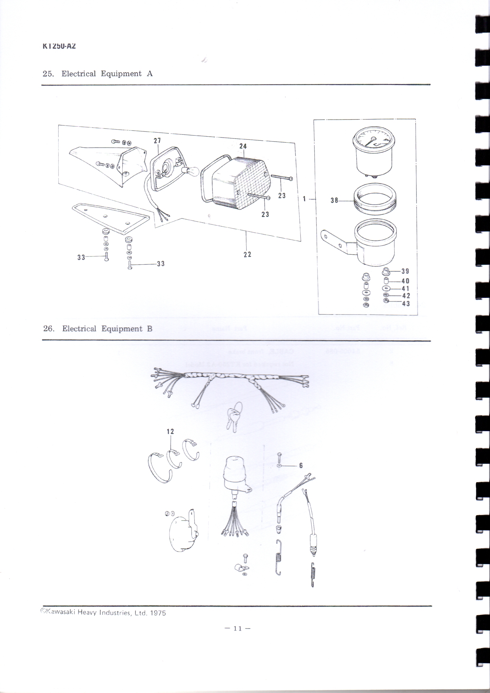

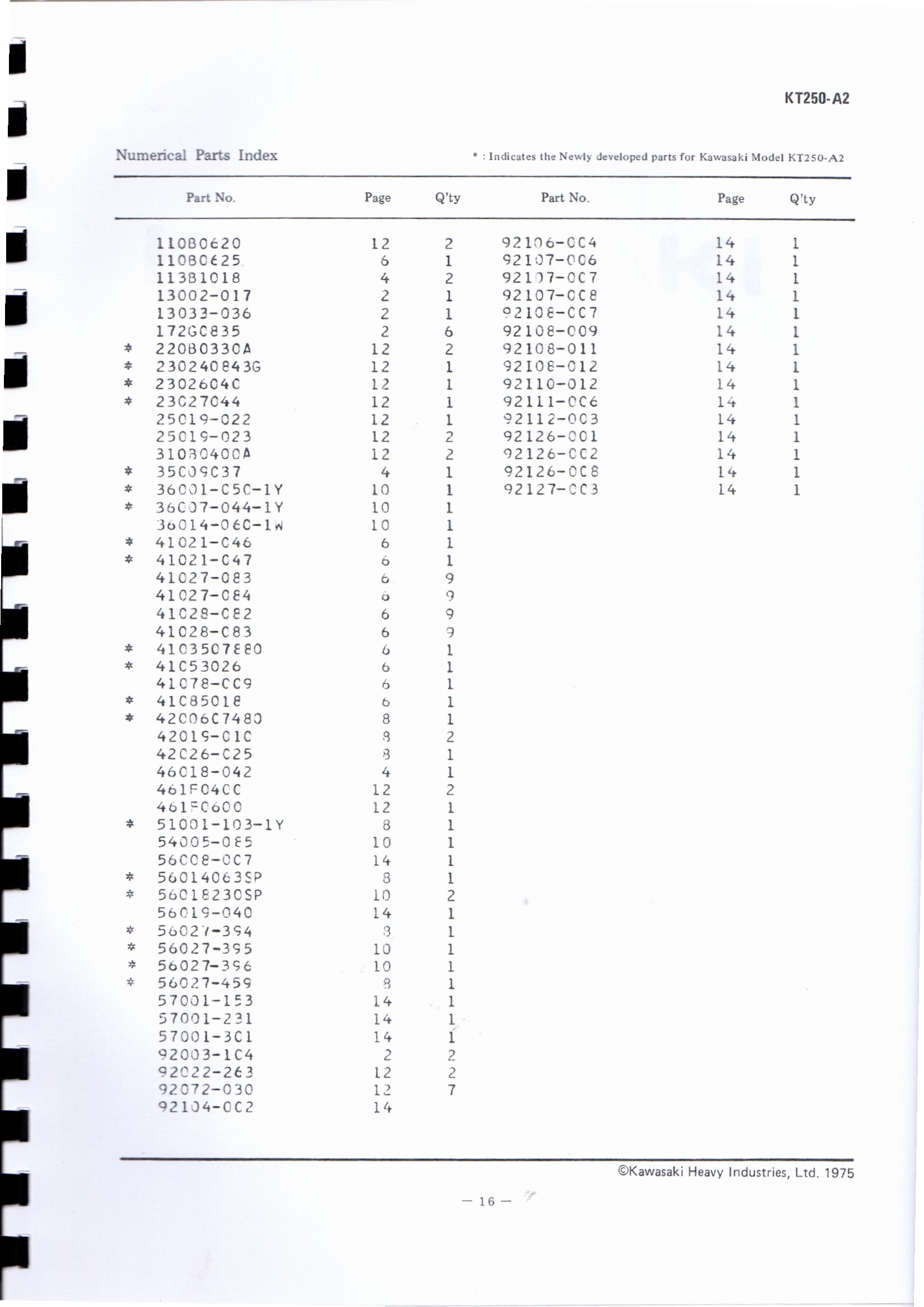

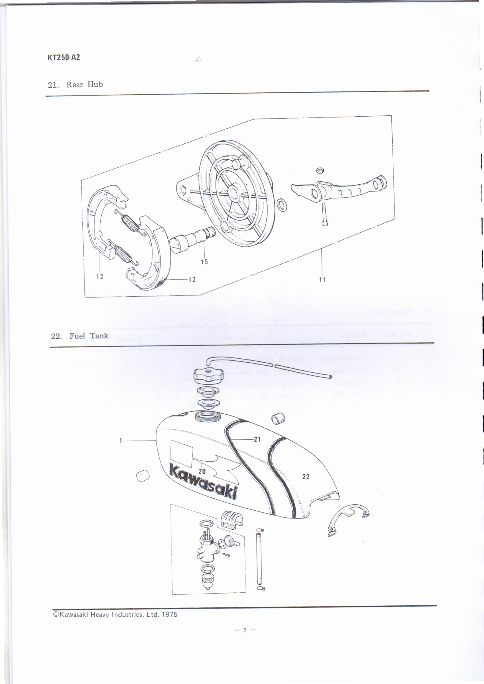

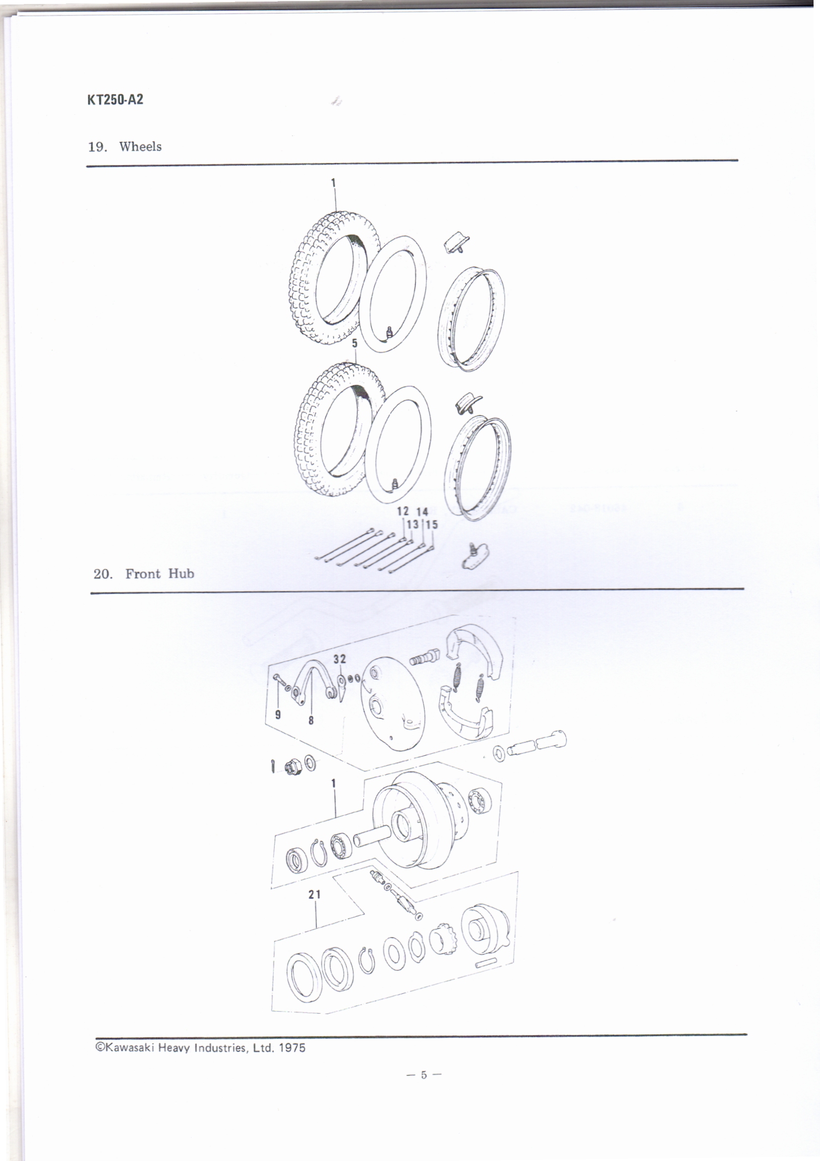

Posts: 351
Re: kt 250 differences

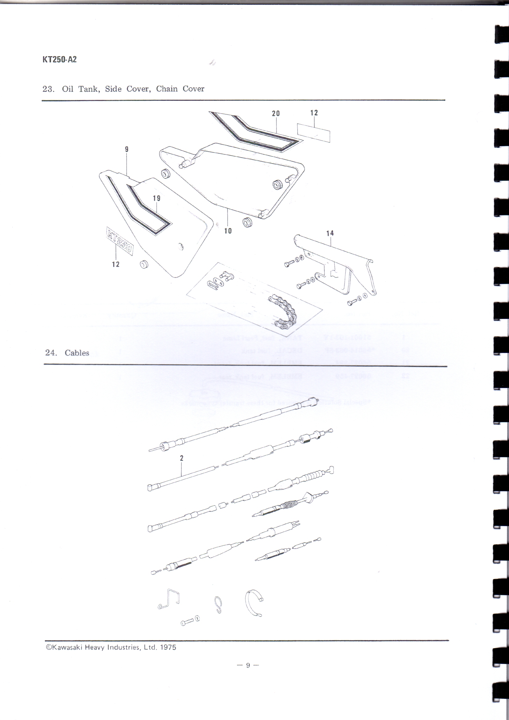

No major changes, just small stuff from what I can see from my parts manual for the '76 A2, note that only the numbered parts are different between '75 A and '76 A2. Also frame and engine numbers start with KT2 on my '76 A2.
Differences between A and A2 FOREWORD.jpg (369.11 KiB) Viewed 4398 times
Differences between A and A2 Part Numbers.jpg (328.95 KiB) Viewed 4398 times
Differences between A and A2 page 1.jpg (203.22 KiB) Viewed 4398 times
Differences between A and A2 page 3.jpg (188.58 KiB) Viewed 4398 times
Differences between A and A2 page 5.jpg (627.5 KiB) Viewed 4398 times
Differences between A and A2 page 7.jpg (705.44 KiB) Viewed 4398 times
Differences between A and A2 page 9.jpg (618.72 KiB) Viewed 4398 times
Differences between A and A2 page 11.jpg (702.16 KiB) Viewed 4398 times

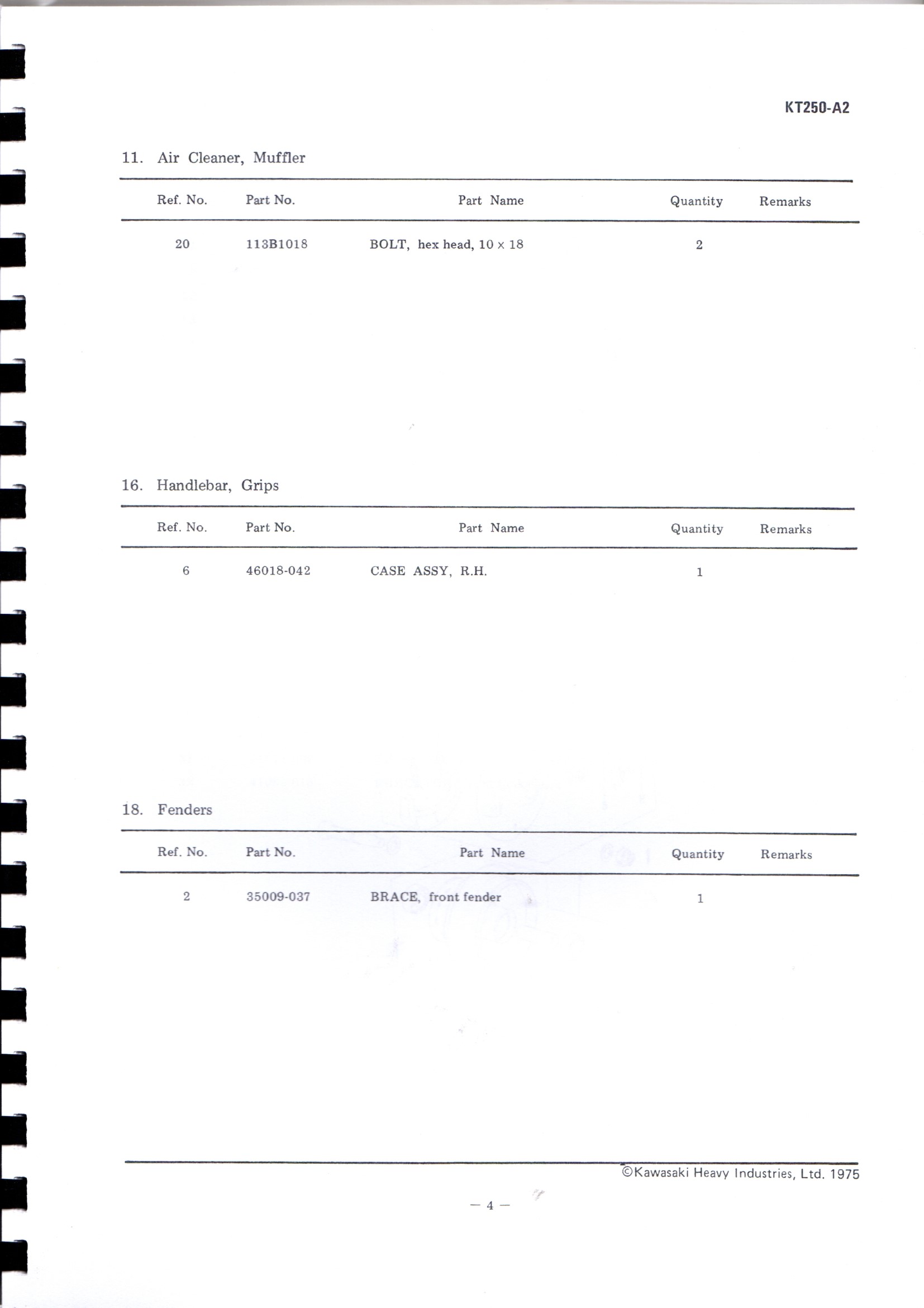

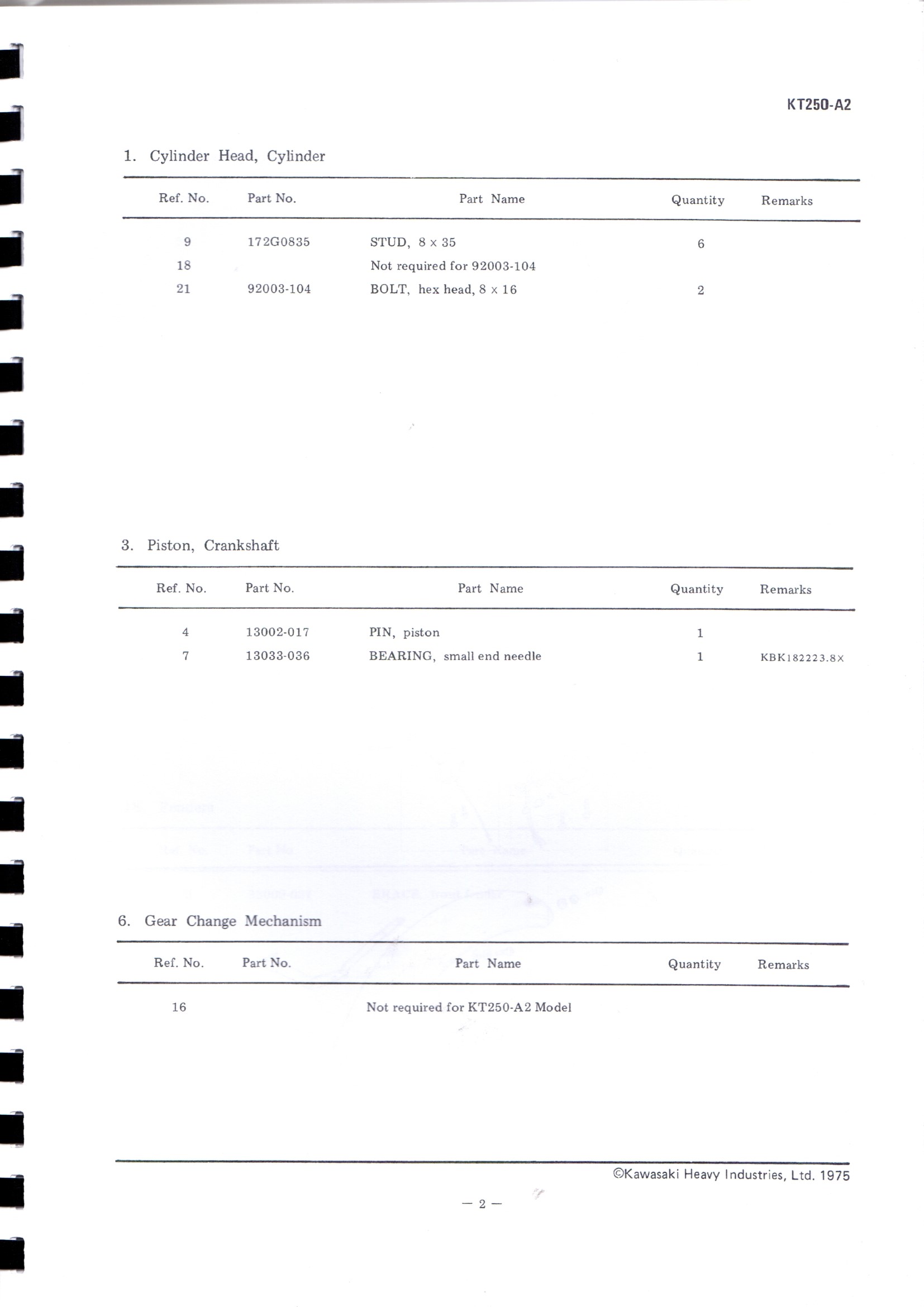

Posts: 351
Here's the even numbered pages with the part numbers and descriptions.
Differences between A and A2 page 2.jpg (217.25 KiB) Viewed 4378 times
Differences between A and A2 page 4.jpg (195.99 KiB) Viewed 4378 times
Differences between A and A2 page 6.jpg (229.3 KiB) Viewed 4378 times
Differences between A and A2 page 8.jpg (195.22 KiB) Viewed 4378 times
Differences between A and A2 page 10.jpg (194.51 KiB) Viewed 4378 times
Differences between A and A2 page 12.jpg (238.63 KiB) Viewed 4378 times
Knock yourselves out.
I also seem to remember that the front brake lever on the backing plate was different between the 75 and the 76 models. Not sure why that point has stayed in my mind for this long though!
Posts: 351
Hey Graham, other than gudgeon pin and bearing, the front hub seemed to be the most updated mechanical parts.
