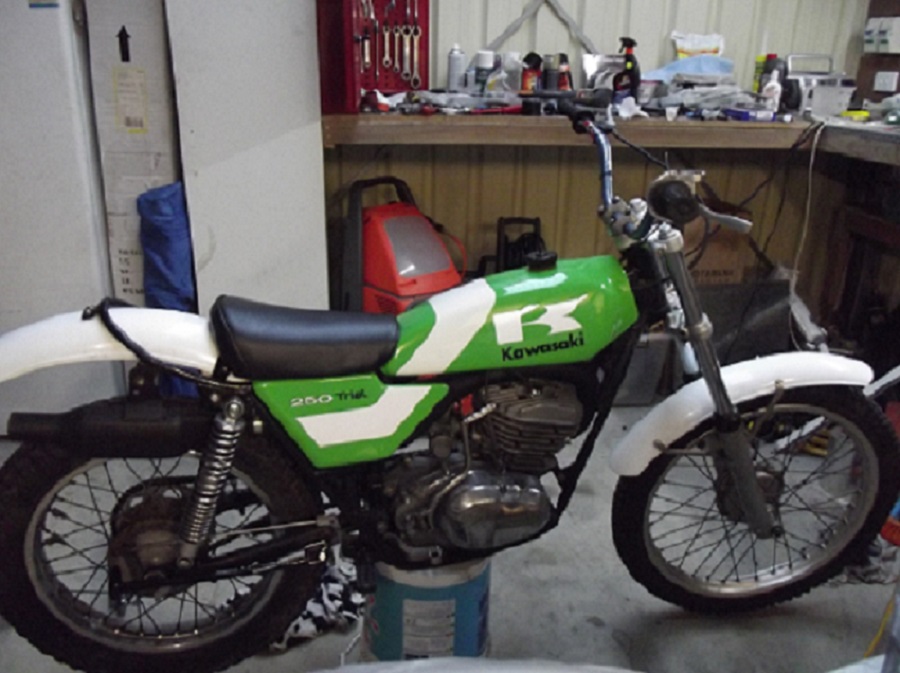

Here is mine, looks better than it is so a full strip down will take place
Not a much work as your new project :shock:
