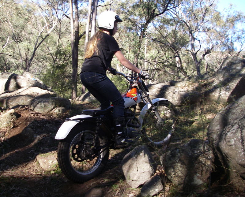

Team Hardwood ventured down to Denman this weekend for their 2 day Trial and what a great weekend it was, Twinshocks everywhere! The sections were superb with an excellent selection of diverse lines, almost as diverse as the bikes
There was even an all Girl Honda TL 125 Challenge, Abbey and Donna had a good close competition on pretty much identical bikes.

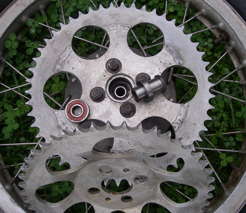

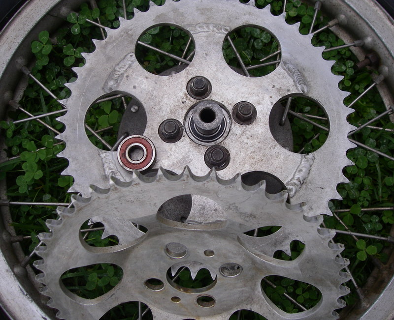

rear axle. 12mm axle in the rear with the tiny 32mm x 12mm bearings so far in from the swingarm, what were they thinking? They have used 3 bearings with 2 on the sprocket side, but the bending moment is too far from the support of the swingarm. Your secondhand sprocket adapter has worked out well, with a little tweak in the lathe, it now has an extra 32mm x 20mm bearing the runs and spreads the load on the hardened spacer. We are probably best off machining up another one for your

Gee Greg the rear axle is bent on that
, it looks as though it's the shape of a banana.
I didn't realise it was that bent. I will definitely need a spacer for the
350 so that the same thing doesn't happen. Greg I know you like low gearing on your bikes, can you tell me how many teeth on that rear sprocket? I don't have a front 10 or 11 tooth sprocket, but I'll get you one when I order more parts. I think the standard dished rear sprocket I have (same as in the photo) is 42 tooth and i will run an 11 tooth on the front as you know I prefer to have a slightly taller first gear. I think David likes a really low first gear on his
Greg I am still short a nut, as I need a front axle nut and like you said is the same for the rear axle. It's a 12 x 1.5 possibly.
