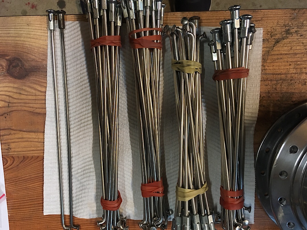

While cleaning the spokes today I discovered I had one short one :cry:
Which also means I have a nipple with a bit of thread rusted in it !
So I might bite the bullet and buy all new spokes and nipples for both front and rear wheels.

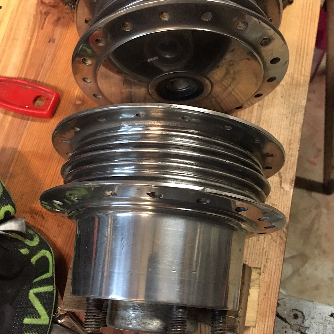

Well I started cleaning the hubs and somehow they finished up like this.
I have ordered new stainless steel spokes and should have them before Christmas so I will have some interesting work ahead.

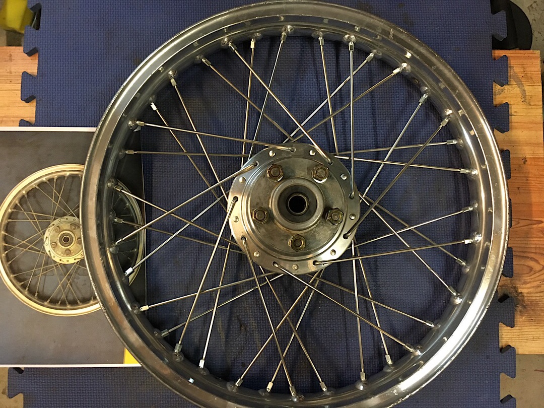

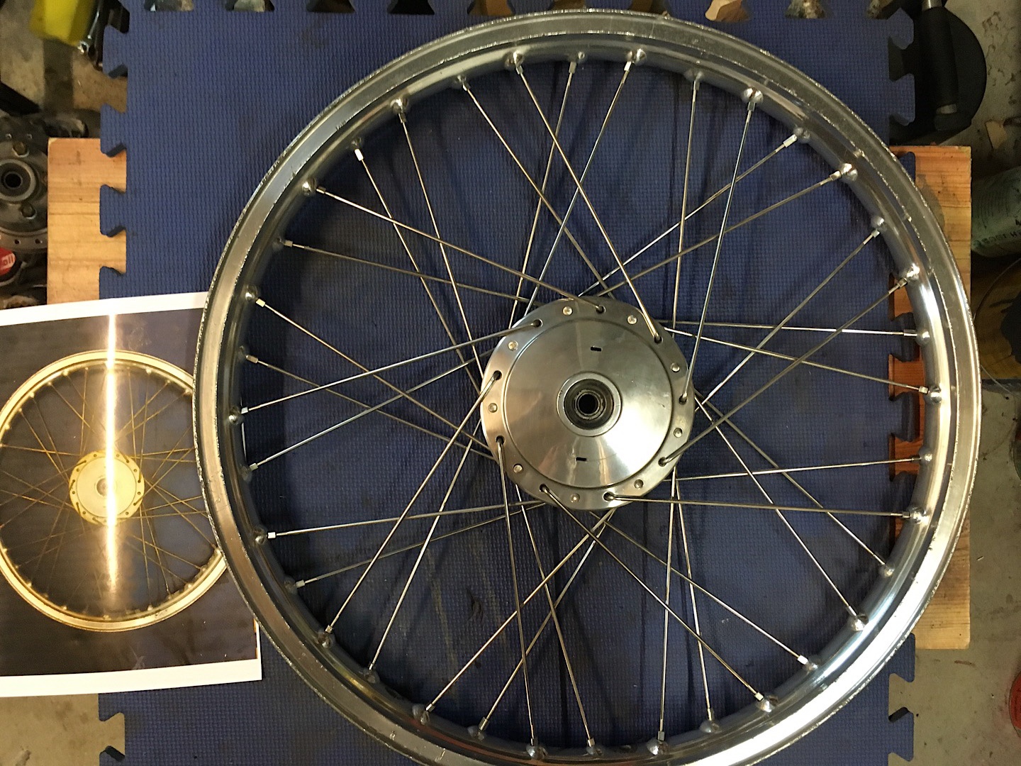

Had some time today so I assembled my wheels.
Laced up the hub similar to the original photo.
Layed the rim over the top and installed the nipples following the photo.
Laced up the rear wheel.
Yet to true and tighten the spokes.
