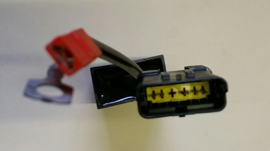

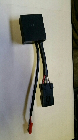

2015-11-06 05.49.30.jpg (251.2 KiB) Viewed 32633 times
2015-11-06 05.51.36.jpg (83.97 KiB) Viewed 32633 times

Looks identical.. How much you thinking? :mrgreen:
