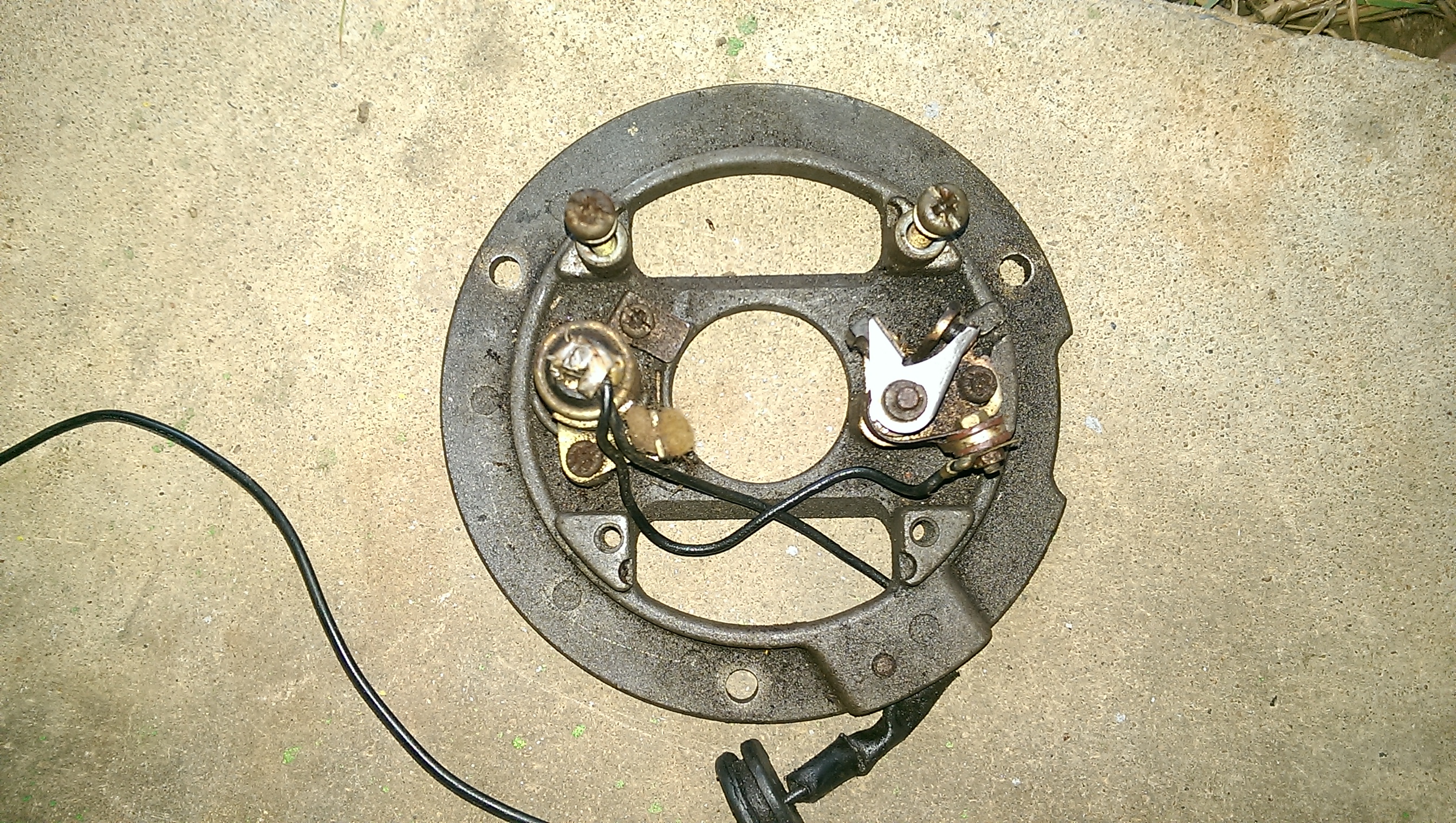

Here is a stator plate from a TY250D. I test-fitted it to a TY250A motor and it fits fine. $20 plus postage. I can take it back to a bare plate to make it lighter for posting if you want
I also found two complete TY250 stators. One of them (B model) looks great and I'm sure is in working order because it has run the motor it is fitted to. The other one (D model) looks OK but has not been tested

I am interested if you know if the A model has slotted backing plate for rotation /timing adjustment ?

I just looked up the parts numbers for stator plates in three Yamaha parts books (TY250A, TY250A/B and TY250C) and they all had the same part number. I also checked the engine number on the bottom end I reckon is from an A model and that I test fitted the stator plate to, and it was 434 - 01XXXX. I have not gone to the trouble of pulling my (very early) TY250A ride bike apart for a look.
I've not seen any 1970s Yamaha dirt bike with slotted stator plate holes. I know they are slotted on Bultacos etc, but it is not the Yamaha way, probably because there is really only one ideal location for the coil to be, relative to the passing magnet at the time the points open, so at any location other than the ideal, the voltage pulse generated will be less than at the ideal location. I've never had a problem getting the timing right on a Yamaha just by changing the points gap.

I've removed the points and condenser so the plate is flatter for posting and to save weight, but can put the bits in a bag and post them too, but it might cost a bit more for postage. Please tell me what you want so I can go to the post office
