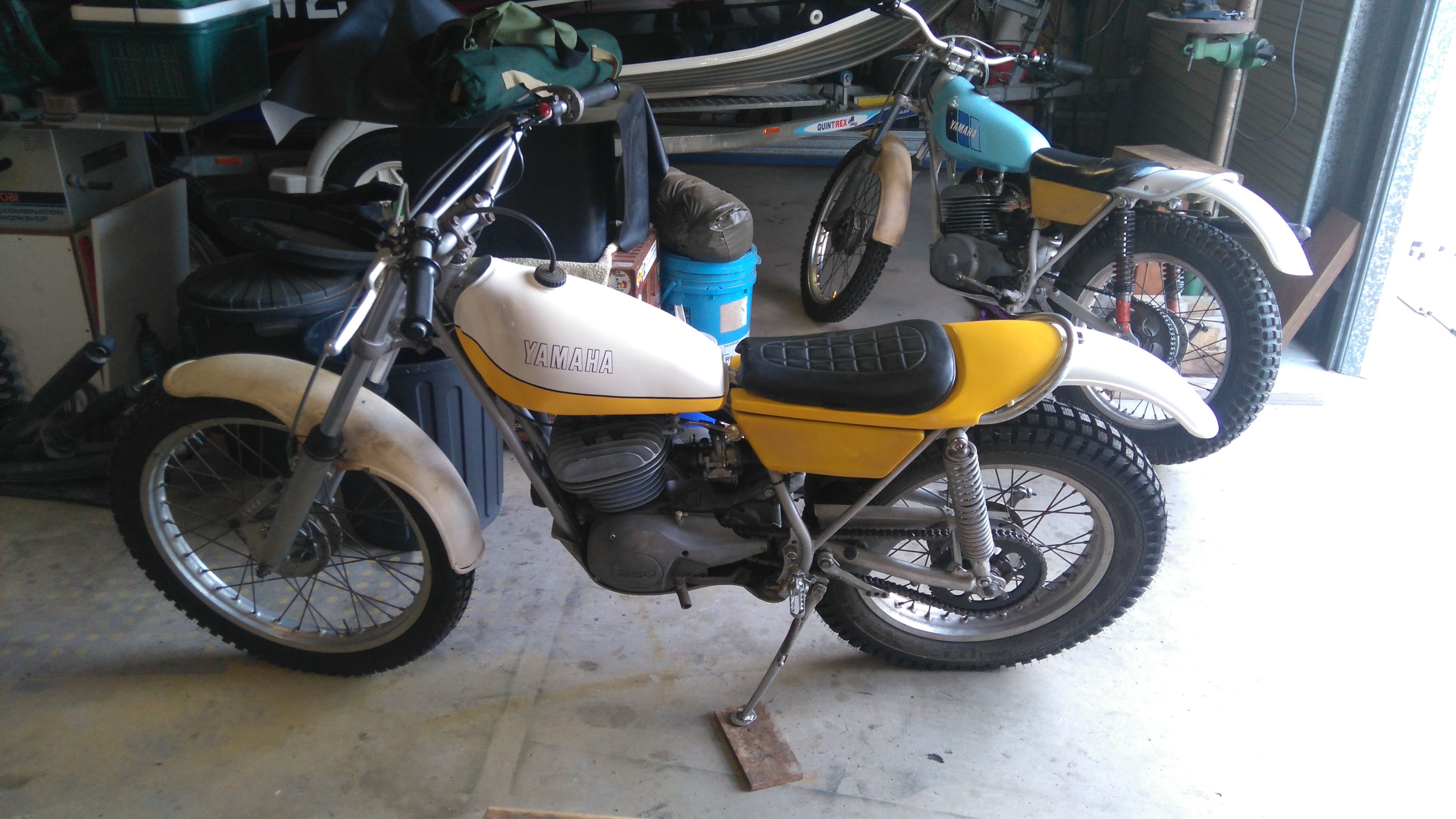

This is my A model with original tank paint to show where the colour split goes.
The yellow on the A model is the same colour as the yellow on the B model.
Maybe there's a paint shop near you that can use a colour scan from another paint shop, so someone with the original yellow colour sample can get it scanned for you where they live and your paint shop can use that info somehow to make you up a rattle can.
You can get two-pack and acrylic lacquer colour matched paint in a rattle can at paint shops. My friend's TY250A was done with two pack rattle cans.
I painted a TY175C tank for a friend using paint shop colour matched rattle cans of acrylic lacquer and it looked great.
