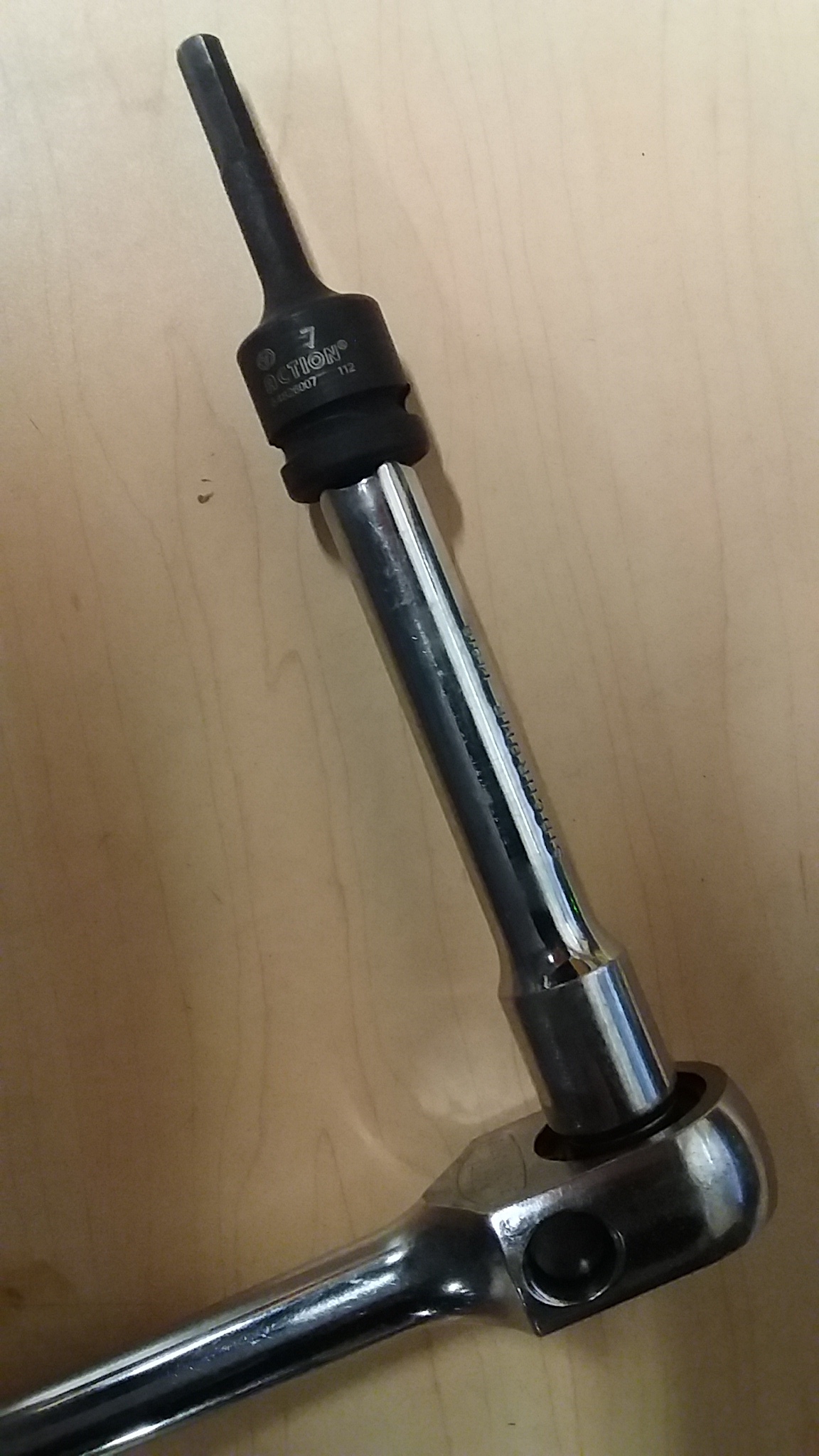

They are not a hex nut that you can get to with a chisel, they are a cylindrical nut that takes a 7 mm allen key as others have stated. WD 40 etc down the hole and then a set up like this should do the job..............

Rod wrote:They are not a hex nut that you can get to with a chisel, they are a cylindrical nut that takes a 7 mm allen key as others have stated. WD 40 etc down the hole and then a set up like this should do the job..............
Ooh yeah that looks the goods Rod
