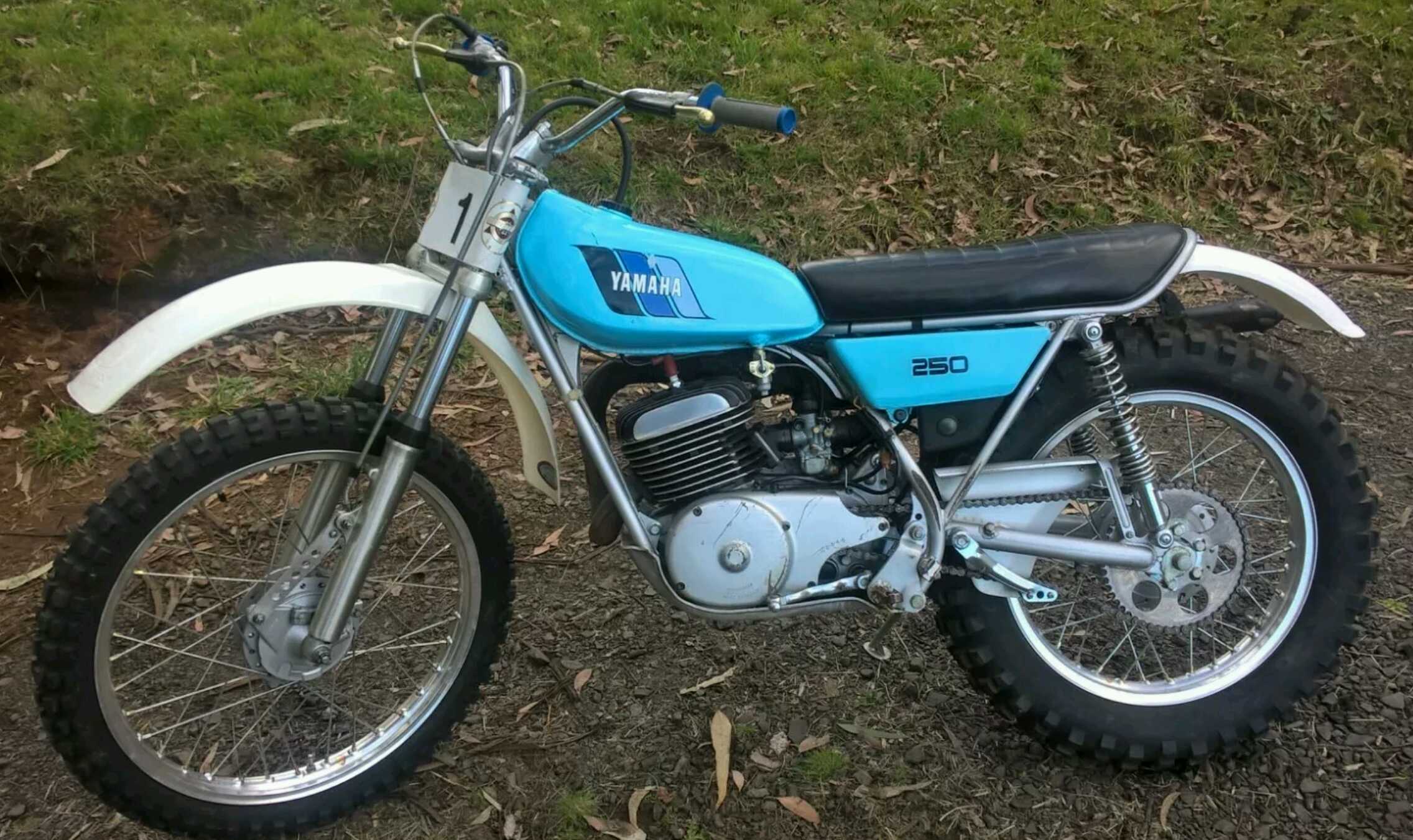

Given the rarity of the trail conversion... I was surprised to see a TY250 appear yesterday on Aus EBay, resplendent with the entire kit.

Alastair, was your :yamaha CAT kit sourced via the Australian dealer network?
I see that D model with the CAT kit on eBay was imported from the USA

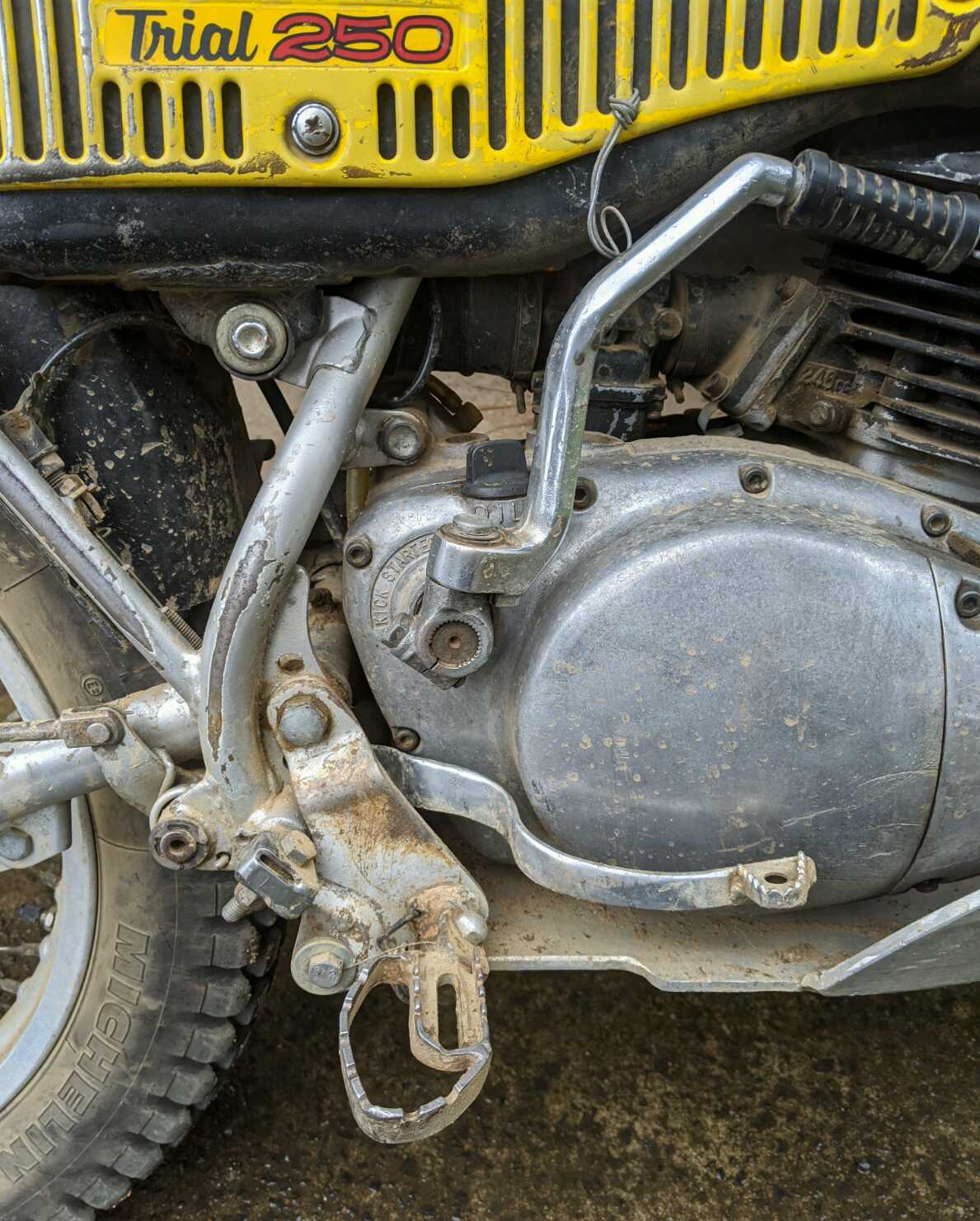

I have 2 trail kits, both sourced from the US.
One was a NOS kit that I no doubt paid an exorbitant amount of money for.
Later I spotted a "bit of a kit" on eBay and contacted the US bike wrecker and explained the issue of the vital longer swing arm bolt and other bits and pieces.
He had no idea, but found it all bar the peg pivot dodads.
The peg relocating brackets attach at the swing arm bolt and have special plugs that hammer in to the lower frame cross member and then accept a bolt. On my bike the cross member had copped a bit of a hiding so I hammered a hardwood dowel right through and then used a couple of roofing screws. Here is my kit fitted to my beloved "A" model:

Also while I am going, here are photos of the "D" model on ebay I talked about:
