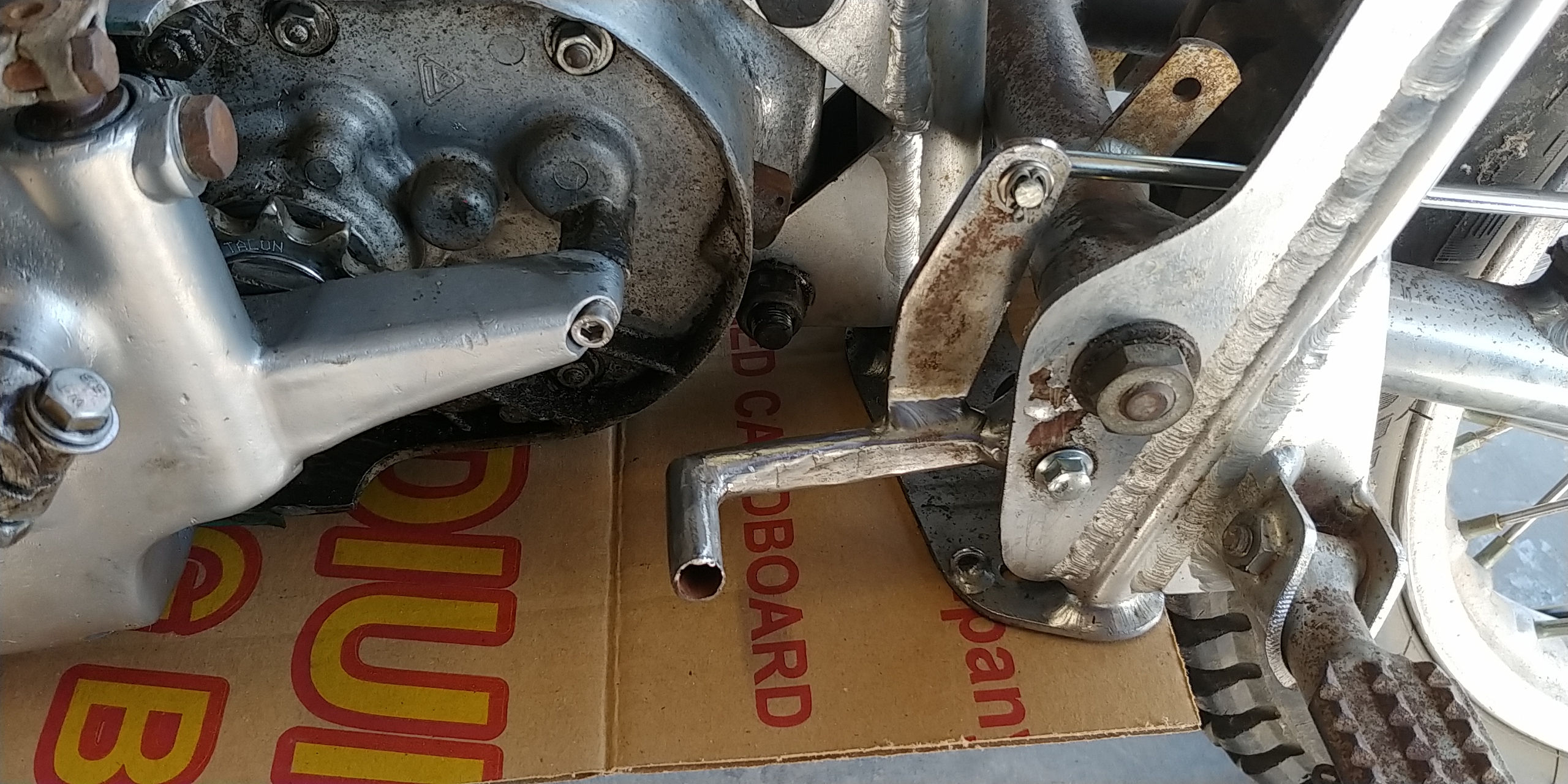

One thing was to set up some rear brakes.
The brake pedal had been extended and was was quite bent so last weekend I removed the ugly extension piece and did some straightening. The pedal is made from thin-wall steel tubing and is held together with bronze welding so I couldn't use heat to soften it for straightening, so it's not as neat as I wanted but at least it should work OK for the test riding.
Before
Before
The brake pedal is now ready for the test riding
