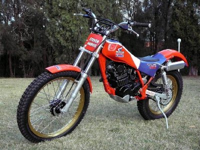

It took me a while to take a picture of my TLR. Here it is

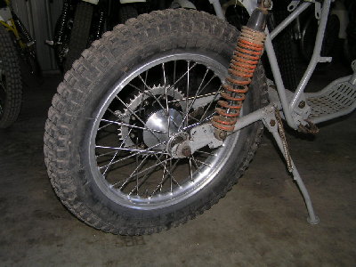

For Tim and others to whom I promised updates of my M198 resto. Both wheels and the forks are now done. Yes it's taking a while.

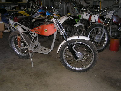

Is that your collection of bikes in the backgorund David ?
Are you sure they are not breeding ?
Re: New page Show us a picture of your Twinshock
Luke yes I'm pretty sure they were breeding for a while. You will notice that they are now parked side by side. I haven't had a problem since I started parking them that way.

Hey David
The proliferation of bikes in your shed looks amazingly like my own.
In fact I'm mid way through setting up a rack / gantry system to free up floor space.
I suspect it may curtail their breeding habits, but truthfully, I'll be a bit disappointed if that proves to be.
I wonder how many others out there have a similar problem with motorcycles unexplainably breeding???????????
At least with so many colours it does help to confuse the leader of the opposition!

Yes Alastair. A rack system is a great idea. A little bit to the right of that photo is where the non-ridable bike storage area starts and above them everything light enough for me to lift into position hangs from a steel rail mounted just under the roof. A bike frame with suspension still fitted is about as much as I can lift above my head. The heavy parts are kept in steel framed shelving built along other walls.
I've also found that while a bike in pieces is harder for the leader of the opposition to recognise, an assembled bike is easily the most space efficient way to store it.

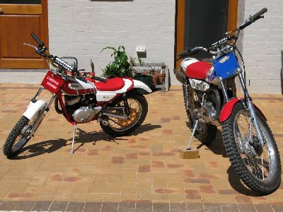

G'day all, here are the fruits of the last four months work. What started as a rolling basket case has turned into quite a nice rebuild of a TY80A.
Frame is totally standard, swingarm had new bushes and an aftermarket tensioner added. Betor shocks. Aftermarket seat cushion on the existing base. Aftermarket wide pegs. Engine totally stock, fully rebuilt and requiring a new crank due to corrosion around the main bearing seals. The engine had been standing outside without a filler plug and was full of water. New gear selector shaft due to someone welding a lever over the splines. New bearings, seals, kickstart shaft. The carb is made up from the best bits of three. Tank is stock, cleaned and repainted. I decided to go with the later euro white/red colour scheme which I think looks great.
Forks are in good condition and work really well. Numerous components were needed throughout including original guards sourced from the UK. The suppliers were:
JK Hirst (UK)
CMSNL (Holland)
France Trial Classic (France)
Maitland Motorcycles NSW
The front wheel rim has been rechromed and I managed to source a NOS hub from the states for $50.00 the two will be joined later this week.
Most difficult part was finding an airbox. I eventually sourced one on ebay from the US.
The 175 was last years project. I still need a trials silencer if anyone can help.
Regards
Andy

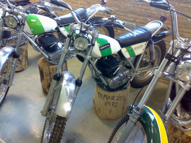

My first ever twinshock was an Ossa MAR 250 & after a recent visit to the OSSA Museum in Spain I got a twinge of nostalgia after seeing a row of them all lined up. Not sure if I had the '72 or '74 as all i remember was that it had a green stripe on a white tank. The museum was pretty impressive, 3 floors with the top 2 being dedicated to Ossa motorcycles & the bottom floor being full of OSSA cinema projectors (which is where the logo originated from).
I have attached pics of the 2 models which i suspect 1 was my first trials bike.
I have more pics from the museum if anyone's interested.
Don Murray
p.s. Thanks to my Sherco agent from Tassie (Nigel Munday) who is an OSSA enthusiast for suggesting we go there. He was trying to fit the very rare 303 model (less than 100 made) up his jacket.

They are wonderful looking OSSAs Don. Please post up your other photos, especially the unusual/rare trials models we didn't get here.
