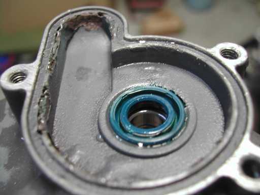

Stork/Cedric – in my opinion the problem is caused by a number of contributing factors, primarily the OEM Bardhal coolant that the manufacturer endorses (if thats what is used?). I suspect its corrosion prevention capabilities do not suit cooling systems where magnesium is present (Rev3 03-08). I am not 100% sure if electrolysis is a contributing factor here but what I do know is the cavitation effect from the water pump impellor works to lift the protective coating on the casing near the impeller thereby exposing the magnesium to the coolant and the casing then starts to disintegrate. The magnesium is also exposed to coolant on the inner surface near where an o-ring seats and from the below photos one can see this is clearly a weak point and also possibly where the reaction starts. As a result of my testing, casing failure can be avoided by ensuring a compatible coolant (Motul Motocool Factoryline Organic) is installed from day one of the vehicle’s life. This is the only coolant that has shown positive test results – it does not attack the magnesium in the event the protective coating lifts.

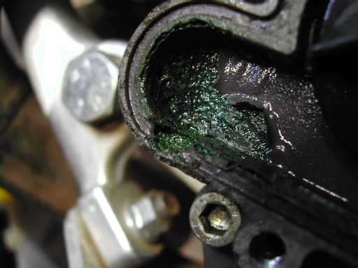

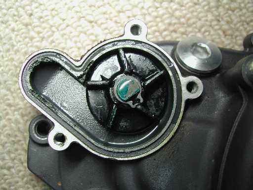

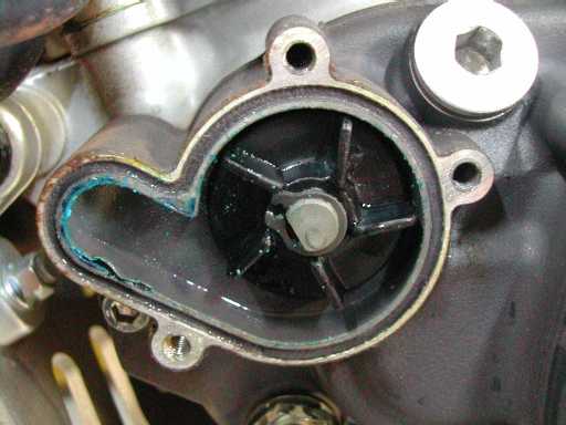

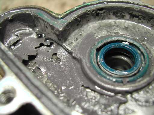

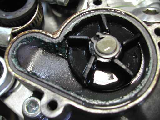

Below are some photos of just some of the cases I have seen.
