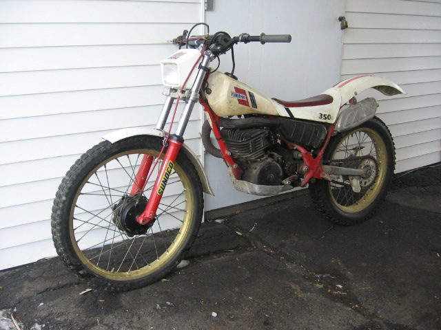

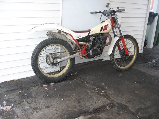

Well, I just picked up my new toy yesterday, a TY 1986 350 It's not a show and I think it will spend some time in the basement so I will need some parts, probably a piston kit, seals, bearings, cables etc. So any info on where I can get those parts and any advise on replacements is very very welcome
Than's in advance
Guy
