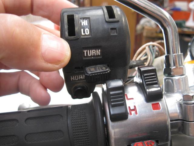

22 I’m using the 206 shell wired to suit our wiring loom requirements as I think it looks better. (not original I know)
22 206 (Small).JPG (31.97 KiB) Viewed 3566 times

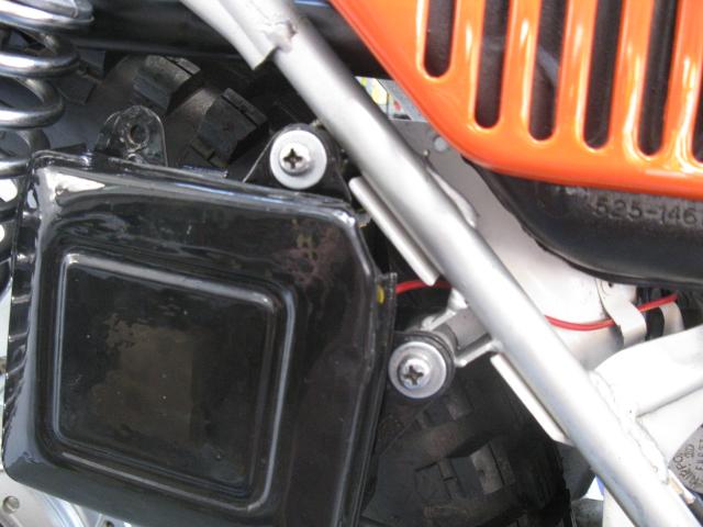

23 I believe these black plastic cases are the right ones for us. Don’t look as good though
23 std v mine (Small).JPG (47.53 KiB) Viewed 3566 times

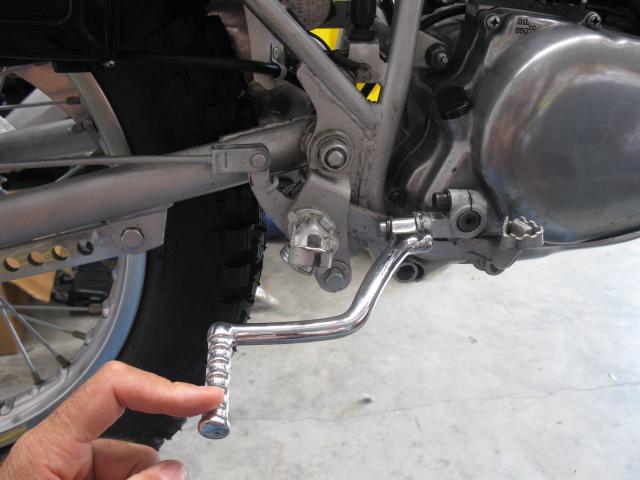

24 when I put this motor back together I think I put the kick starter starting point in the wrong position. It sits at the top like normal but does not get compression till there.
24 not right (Small).JPG (42.78 KiB) Viewed 3566 times

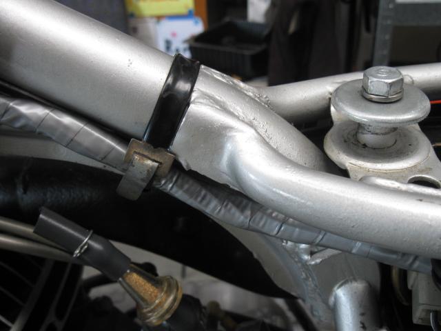

25 what type of loom holder goes there
25 loom holder (Small).JPG (39.98 KiB) Viewed 3566 times

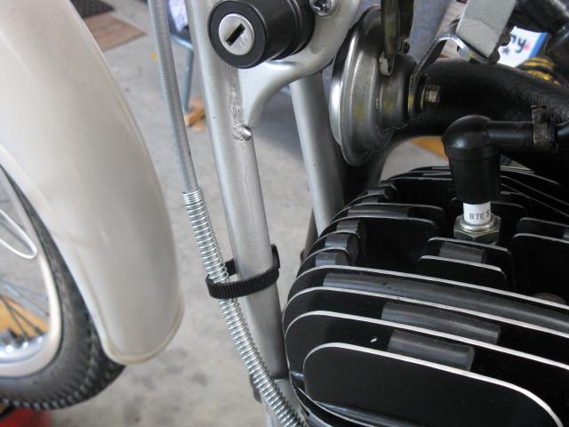

26 what type of cable holder holds the clutch cable there? Metal with plastic sleave, black plastic or clear plastic
26 cable holder (Small).JPG (46.47 KiB) Viewed 3566 times
27 battery box is new thanks to Greg. Are these the right blot and washers holding it on?
27 bolts (Small).JPG (47.76 KiB) Viewed 3566 times

24 it does take 1/4 turn to engage. They usually start to drive at about the same height as the footpeg. Yours looks a tiny bit low.
26 not sure but think it is zinc plated and no plastic

Hi David
is 26 like 25?
