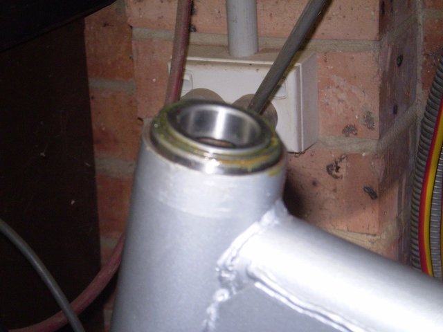

I recently bought a tapered needle roller bearing and seal kit for my 74 ty250 but whilst the diameter is correct, the top bearing protrudes an extra 7mm and this prevents the top locking nut from fitting. Has anyone else tried these kits and if so did they fit. The company I bought them from has been helpfull but is baffled by the issue. Any advice would be appreciated.
Greg :?:

Hi Guys, I have posted a photo of the top bearing installed and for my money it sits too proud. I checked the numbers on the bearings and they all stack up as per Davids measurements. I will go through and check the installation of the bottom bearing but I am sure I have that seated properly.

OK, 3rd time lucky. I used the original seal cleaned and reseated the bearings and managed to get about 5mm of thread for the adjuster nut. It's not what I'd like but there's plenty of engagement for the thread. Good chatting with you chaps and thanks for the advice.
