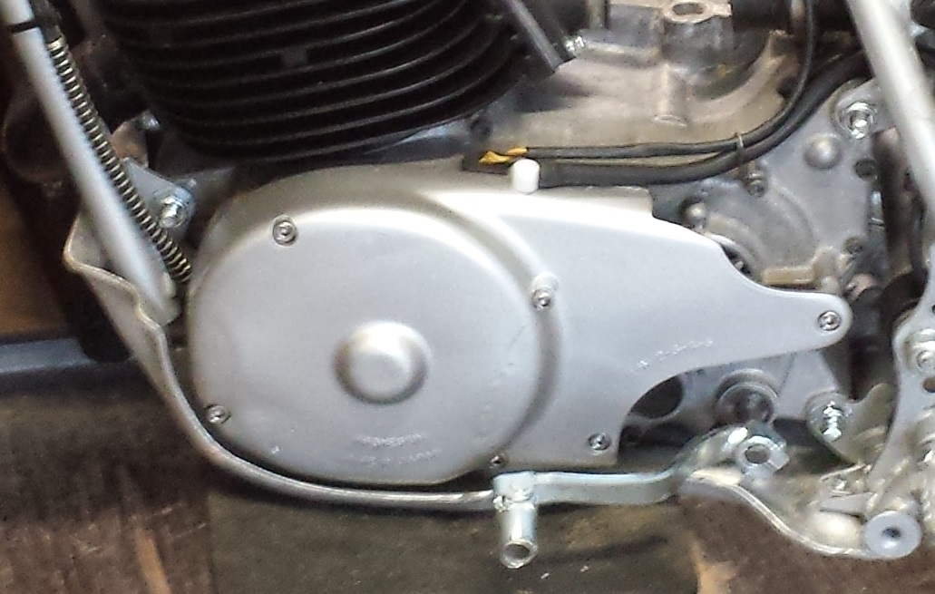

Correct Jools, mission complete. I use a rattle can from Supercheap, Dupli-Color Engine Enamel - Aluminium colour, 2 coats. Sanded back and scrubbed with Metho and used Dupli-Color Enamel Primer first. The Aluminium colour doesn't sound good but the finish isn't too bad and not a bad colour match. No clear used as it has a satin finish. It may not be perfect for the purist restorer but photo attached and you can make your own judgements.
Dulpi-Color Engine Enamel
008 - Copy.jpg (191.67 KiB) Viewed 4429 times
