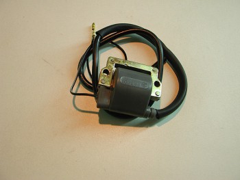

Re: Replacement Motoplat Coil
This is what they look like
Post by keychange »
Thanks David that looks like what I am after
